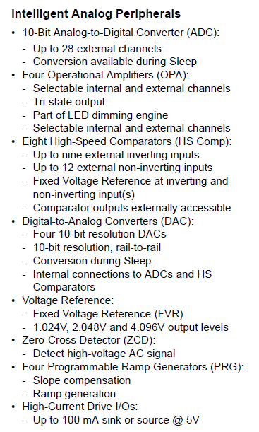

The pic micros below have 8bit and 5bit D-A DAC settings in flowcode whereas the data sheet shows them to be 10bit and 5bit
pic16f1773,/1776/1777/1778/1779 & LF versions

Please note also that the ADC bit depth is set to 12bits whereas the data sheet says 10bits
