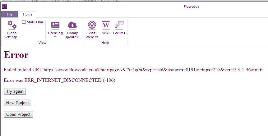

You do not need any internet connection to run any version of Flowcode.

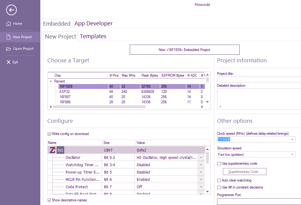

You only need the internet to (obviously) download the software and any subsequent updates. When FC starts it does try and look to the website to see if there are updates etc but this connectivity is not a requirement. You can simply "click" on New / Open project and it will work fine. Did you try that?
In v9 I switched off my WiFi and :-
Clicking on "New Project" :-
You can see that I can create and use FC as normal.
