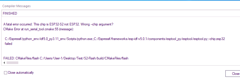

Fueled by getting the ESPv5 toolchain installed and compiling I created a small chart to hopefully flash an LED connected to #18 of an ESP32-S2. Previously I had only compiled to Hex for S2 but to chip for ESP32 using v5 without issue.
All went well up until it connected to download, where it failed with the following message
Attached is the chart
Is the S2 not yet supported?
ESP32-S2 seen as ESP32

Re: ESP32-S2 seen as ESP32
In the Python console
entering either of the lines returns a syntax error not liking either "set" nor "fullclean". Tried various "set" combinations such as set_target etc. No luck
I'm possibly doing something stupid (again).

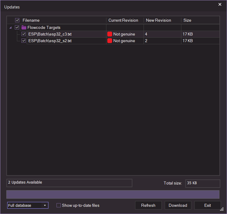

Hi Martin, Hi Lain
I am sure but does it have something to do with the hanging update?
It's about the S2
Update:
It's about the S2
Update:
Iain,
Can you run - idf.py - if you are using esp32 v5.0 cmd you'll need to cd to the right directory.
If using cmd then you'll need to do export.py first..
I'll try this evening with a c3 board...
Obviously I'm still drooling at the thought of my TRS-80 being resurected...
After installing toolchains I thought I'd moved the various shortcuts to a folder, but had moved them to the Recycle Bin instead.
Strange thing, when I was looking for command prompts, although ESP was listed I couldn't open it and after trying, most navigation was messed up.
Anyway, once rescused from the bin I could open and navigate to my floder, folder even, and in there I successfully ran Martin's set-target line.
Once back into FC it compiled to target without any issue. Well........ !
I thought I'd bricked it, or in the case of an eentsy-weentsy uC pebbled it as my blue LED merrily flashing beforehand had now stopped.... My code was to flash the led in a S.O.S. type of sequence. Nothing..... However I'm putting the cause down to continued drooling as per above thoughts... #18 and #13 look a bit the same from a distance and I'd got it wrong... Doh..!
Anyway, even more thanks to Martin for his help as I now can compile to my S2.
