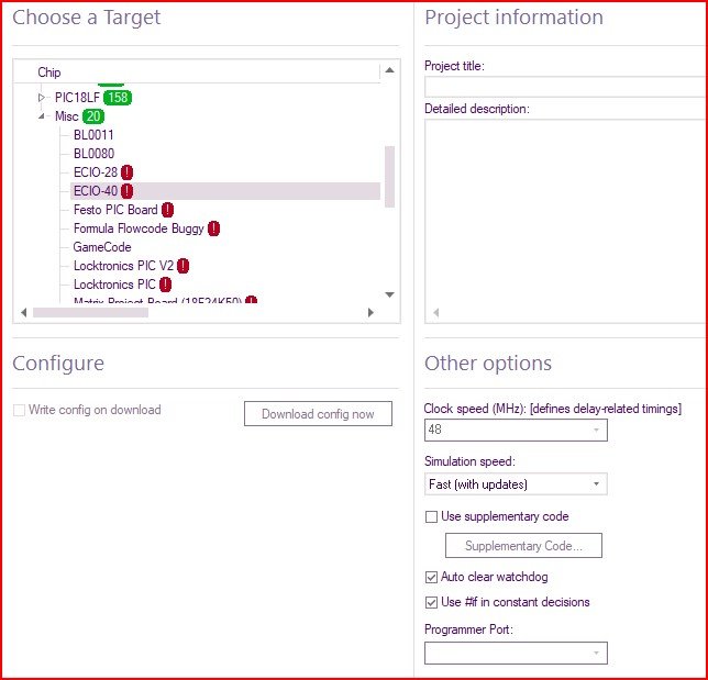

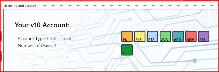

For Flowcode
Regarding Flowcode v10
Here below are components marked in red that I cannot be allowed to use
Licening and account.jpg (37.73 KiB) Viewed 5494 times

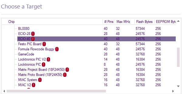

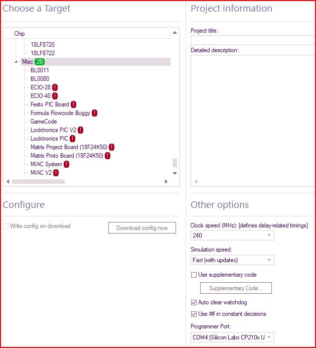

Components that do not work can be seen below :?
Skærmbillede 2023-05-24 072947.jpg (54.08 KiB) Viewed 5494 times

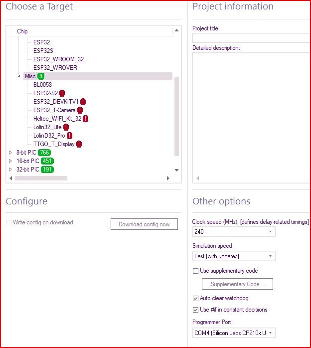

Skærmbillede 2023-05-24 073135.jpg (54.37 KiB) Viewed 5494 times
And 2x Licensing and account I cannot upload to you :o
Can you help me with these components. So I can get to use them... :D

Hi Monie.
You should still be able to compile to them, as there is a visual bug that shows some licensed target devices as not licenced.

If you compile and it does not say "You don't have a valid licence" then there is a different issue.
I have also compiled to TTGO OK.

I have a valid Professional license for 1 user:-)
Posts: 1961
Has thanked: 292 times
Been thanked: 458 times
Re: Components that cannot be used
monie - those targets with the red exclamation mark should compile ok for you. You can safely ignore the red exclamation marks if you have a licence for the associated chip-pack.
Have you tried creating a simple project with one? Are you receiving any errors when compiling to these targets?

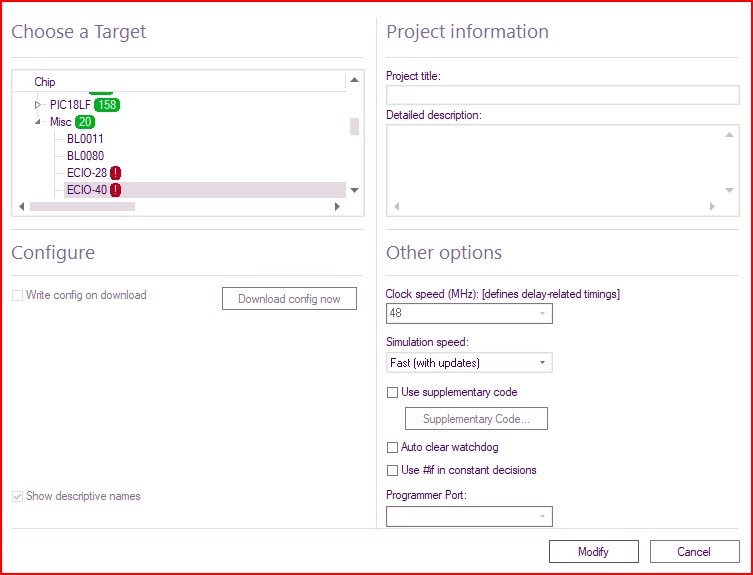

Hi Steve-Matrix
Tried to test ECIO 40P but without success.
At "Program Port:" here I don't have the option to select anything?
See attached JPG-file

Hi Monie.
That is correct, the programmer port remains blank.
Before programming the ECIO, make sure the ECIO LED is solidly lit.
If the LED flashes all the time, then the drivers have not been installed.
They are available here (40 pin)
or
here (28pin)
To program the ECIO40.
Select Build >Compile to target as normal.
You should get a popup stating No device detected etc.
At that point, you press the button on the ECIO to program it.
After pressing the button the ECIO then establishes a connection to the PC, so you will hear the driver-detected sound, and the LED will flash indicating it's being programmed.
After programming is completed the LED will stop flashing and remain on in a steady state.

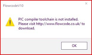

Hi Steve-Matrix
Thanks for your nice description..

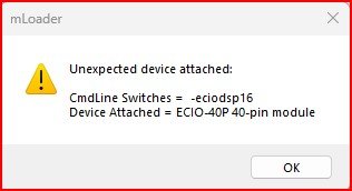

When I try to do as you describe I Get the message: See below!
PIC compiler toolchains
PIC compiler toolchains.jpg (11.75 KiB) Viewed 5455 times
What is the reason?
What should I do. Do you have a suggestion?
Monie
Posts: 2325
Has thanked: 724 times
Been thanked: 783 times
Hi Monie, Your welcome.
Have you downloaded and installed the 8bit PIC toolchain from here?
That message is stated it's not installed.

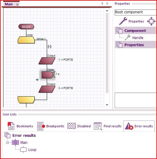

Hi Steve-Matrix
I cannot compile the file for ECIO40P...?
Choos a Targe ECIO40P.jpg (48.88 KiB) Viewed 5400 times
Please see "Compiler messages.pdf" below!
(43.7 KiB) Downloaded 527 times
Hope you can help me so I can use ECIO40 with Flowcode v10.... :D
Monie

Hi Monie.
Does the ECIO have a solid or Flashing LED when connected via USB to your PC?
