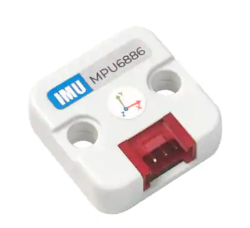

I use a supported IMU the MPU6886.(6 Axis)
mayby it's not what you are looking for but if you tell me what you like to do, I can have a look if it's woorking with this modul
https://shop.m5stack.com/products/6-axi ... nitmpu6886
and is there a big distributor where your WT61P sensor sells?
