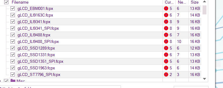

Just what I feared :( After today I update FC 10 and I open an previus project, nothing work anymore, suddently some of the component is not connected any more, has worked perfect?

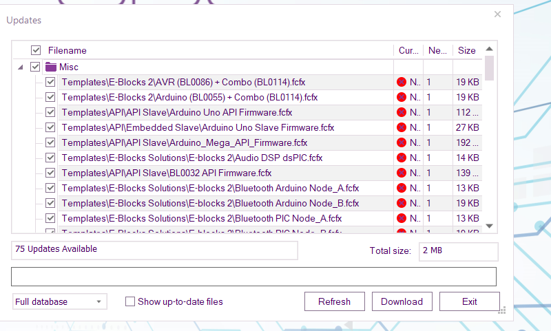

After update, this same screen poup all the time again after I have update look like it not have update. And I get the att. compilermessage when I try to compile my project.
Pls, what to do?
Come again after update.png (76.96 KiB) Viewed 4537 times

Looks like there may still be some unconnected pins. Can you attach the project file?
The display updates just fixed a bug with printing some of the larger fonts as certain orientations. Shouldn't be any other changes.
I have just posted about this issue here: viewtopic.php?f=5&t=2025
In short, you do not need to redownload these template files. Although if you are using the template files to start your own projects then we recommend downloading these updates occasionally to ensure you remain up-to-date.
