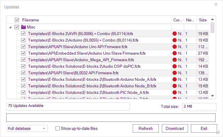

There is a minor issue with the latest v10.0.3 version of Flowcode that means template files downloaded through our library update system are identified as "not genuine". This means that each time the Library Updates window is accessed and "Full Database" is chosen as an option, these files will be identified for download, even though they may be up-to-date.
Flowcode Template Updates.png (50.15 KiB) Viewed 10939 times
Once downloaded, the templates can be used without problem. So there is no need to re-download these template files again immediately.
