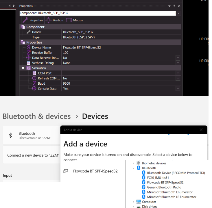

Hello all
just trying to start Bluetooth SPP on the chip esp32 wroom-32.
the copiler runs through without error message and nothing happens.
Apparently I have to change something at some point to get bluetooth to work. no cell phone can find the chip as a participant. why is there no batchfile offered here to make this change. I use FC because I just want to program graphically and can't do anything else. if I could program in c, I wouldn't need fc.

I tested and it's working fine with the batch file and the modificationen in the config.
Creat a new project and it's working

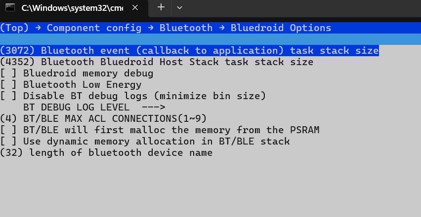

MJU20
Posts: 367
Has thanked: 105 times
Been thanked: 76 times
Flowcode v10 Re: Bluetooth SPP 32 no function
Post by MJU20 »
BenR wrote: ↑
Fri Jul 21, 2023 1:10 pm
I've pushed a change to the library system for the ESP32 build batch files and FCDs.
The new batch file once run using compile to hex or compile to target should generate a new file called "menuconfig.bat" inside the project build directory. For example if your Flowcode project is called Test then in that same folder will be another folder named test and the menuconfig.bat will be inside that folder.
If you double click it then it will now take you directly to the menuconfig tool that will allow you to configure the settings for the project in a graphical way. It looks like what we were trying to do was working but then after compilation the config file was being overwritten and so maybe better to use the inbuilt IDF tool rather then trying to be too clever about things.
On running the menuconfig.bat batch file, the Bluetooth settings are inside the following menu.
Component Config -> Bluetooth ->
Then the Classic Bluetooth and SPP also needs enabling here.
Component Config -> Bluetooth -> Bluedroid Options
Press Q to quit followed by Y to save.
Wanted to change the Bluetooth setting today but can't find the Classic and SPP settings any more?
What version of the ESP32 IDF are you using?

BenR wrote: ↑
Mon Jun 17, 2024 10:26 am
Hello BenR, I'm using V4.x because upgrading to V5.x gives me a lot of problems.
I know I should remove everything from the earlier versions but I need to find out what that is.
Every time I try to upgrade to V5.x I have problems.
