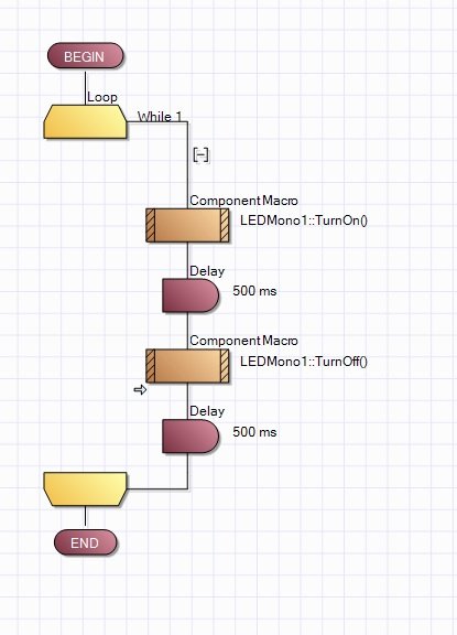

I have made a simple flowchart, just to have a led blinking (F10 code).

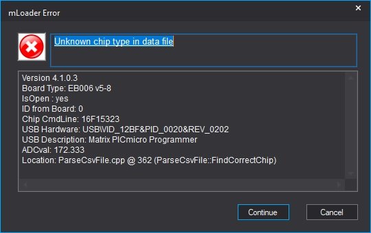

When "Build to target" is clicked, an error ocures (F10 error 01)

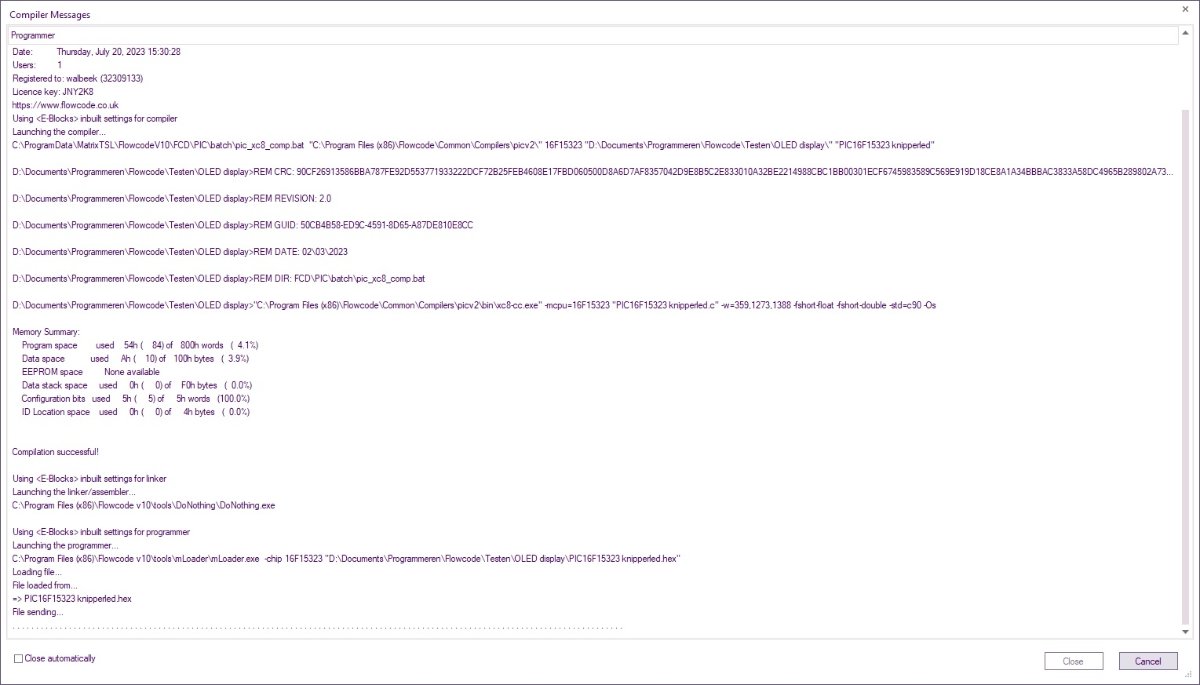

I have also included part of the compiling display (F10 error 02)

Sorry, mLoader does not currently support 16F15323.
To program that device on Eblocks, you will require an external programmer and program via ICSP.
