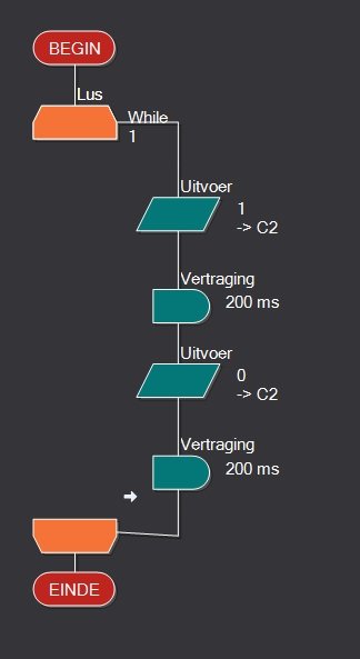

I have made a simple program in FC9 for a blinking led (see attachement)

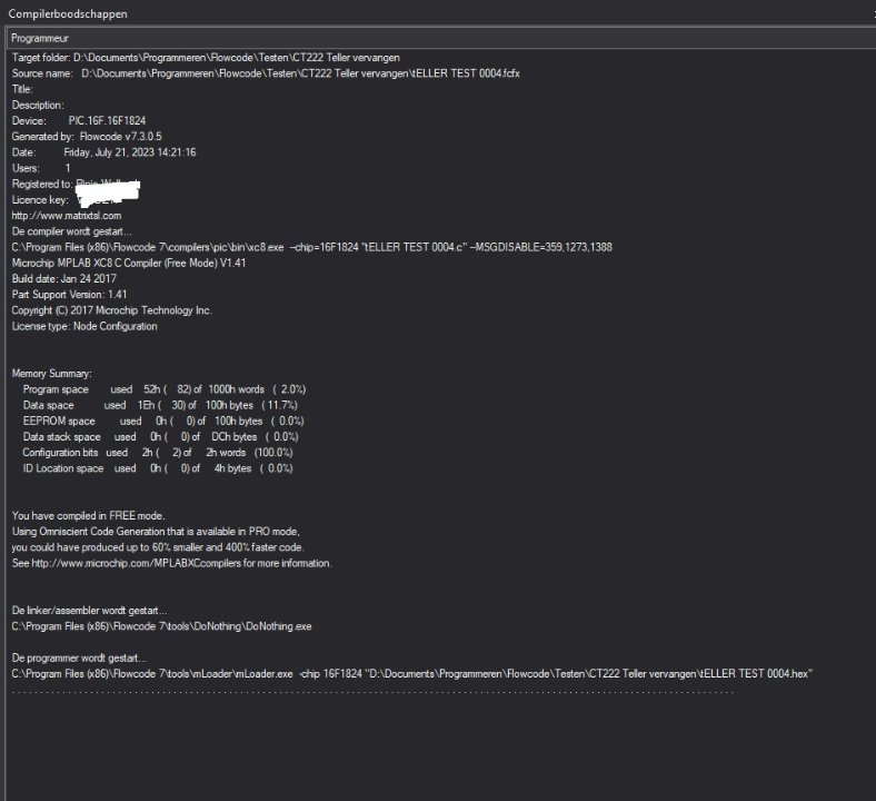

Simmulation works oke, when programming to the chip nothing works.
I have included the compiler message, it keeps adding dots for minutes.
There is no difference is the programmer EB-008 is conncted or not.
What am I doing wrong?

To know more we woul dhave to see your program and know more about your hardware setup, specifically the oscillator circuitry.
