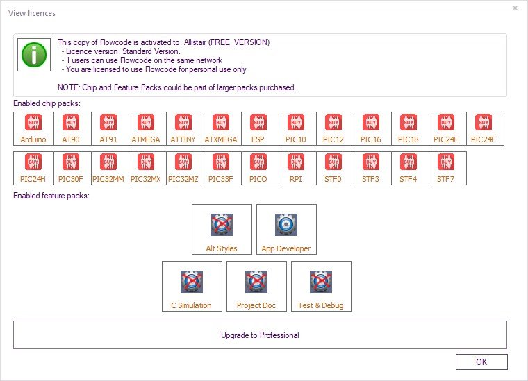

I have installed the PIC compiler toolchain and I have activated the Standard version of the licence.
All this is confirmed when I view the licence page (see attached screenshot).

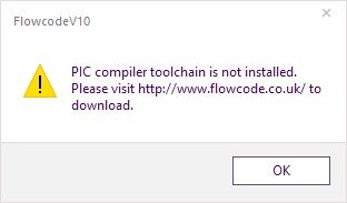

I have a project loaded but when I select the option to Build >> Compile to HEX, I get the message "PIC compiler toolchain is not installed ..." (see attached screenshot).
Yet the toolchain is installed!
- PIC compiler toolchain is not installed message
- ToolchainNotInstalledMessage.jpg (8.83 KiB) Viewed 8559 times

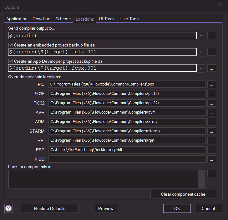

Can you check by the global settings if the location is correct for your computer?
And which PIC do you want to use? Sometimes the PIC16 designation is confusing.
- Snag_3b64f4.png (53.99 KiB) Viewed 8557 times

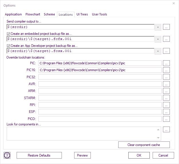

The locations in the global settings were all empty.

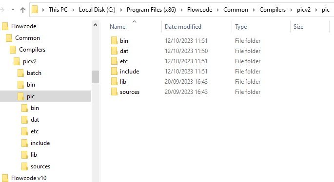

Using File Explorer, I could see that the only available folder for the PIC was :
C:\Program Files (x86)\Flowcode\Common\Compilers\picv2\pic
(see PIC_CompilerFolder.jpg)
I set the above path for PIC and PIC16 locations as shown in PIC_ToolchainLocationSettings.jpg

- My global settings for PIC toolchain settings
- PIC_ToolchainLocationSettings.jpg (52.68 KiB) Viewed 8552 times
- File Explorer screenshot of PIC toolchains folder
- PIC_CompilerFolder.jpg (29.13 KiB) Viewed 8552 times

If you look at this webpage , you will see that only the following microchip devices are free:
Also, these are the correct toolchain paths.
I'm surprised they were not added when the toolchains were first installed.
- PIC16F15323
- PIC16F18877
- PIC18F25K50
- PIC24FJ128GA702
- dsPIC33EP256MU806
- GameCode
