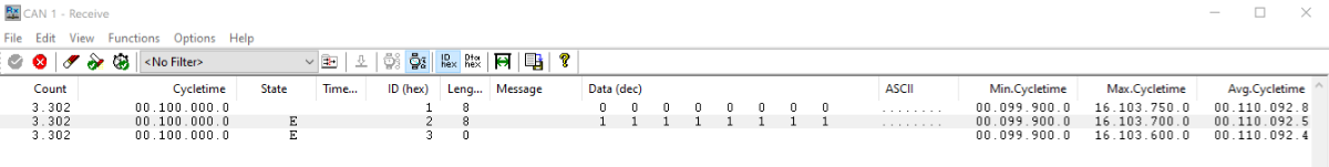

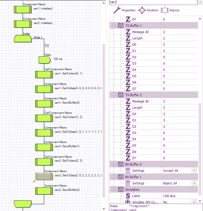

I can now send CAN messages with the internal bus but it does not behave normally.
When I use SetTXIdent it sends as an extended message even if the ID is lower than 2047.
if I use SetTXIDSimple it sends the message as type Standard but then the ID number is wrong. (ID1 becomes ID 40 and ID2 becomes ID 60)
I imagine that there may then be problems with receiving a message when it arrives as extended instead of Standard ID even though it is Standard ID.
It will also not use the pre-defined 3 buffers Data. I have to define Data myself with SetTXData which is ok for me because I only use this anyway :-)
