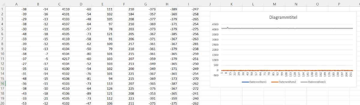

So fast that you can even use it to create csv file with a sample rate of a few Hz!
easy to open the file with excel later.

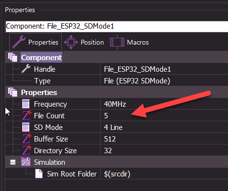

but there is a limitation with the number of file.
if I choose 4 then I can create 3 files, then my programme crashes
if I choose 5 then i can create 4 files, then crashed my programme.
I cannot set more than 5 files count.

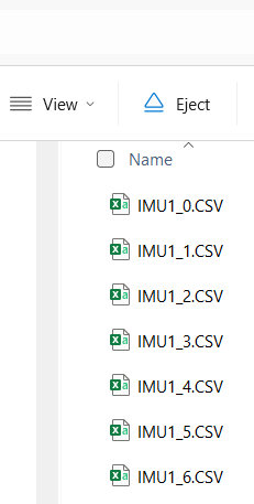

here the recordings on the micro sd-card dependent on file count.

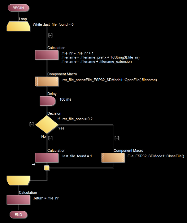

I use the same macro with the "old" esp32 sd-card component to check what name becomes the next recordet file.
i open with a list of which files are already on the card.
If a file is available, I close the file and try to open the next one. Until I can't open a file, I have the next number for the filename.
look for the file on sd-card:

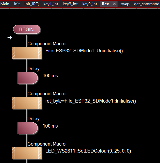

Yes but I don't need a second componet, but before each recording I un-initialisee the component and initialise the same again. That works !!!
Add this:
More files...
