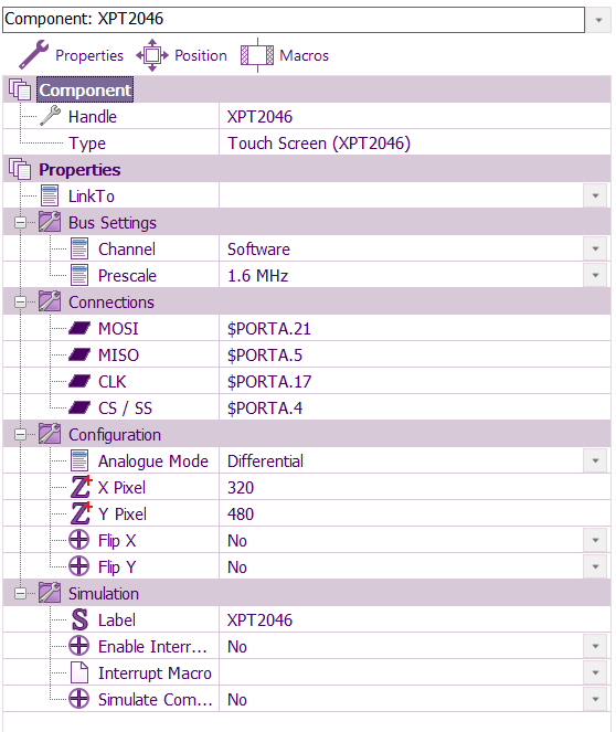

Well, thank´s I am back again it work again, only not for the XPT2046 Touch. Before update after reopen my projects I only have to change back one pin, now when I have saved my project/compiled and open the same project again I have to reconnect all the pin for the XPT2046?
The Screenschot is as I want it, but after saving my project all pin are changed again
Jorgen
