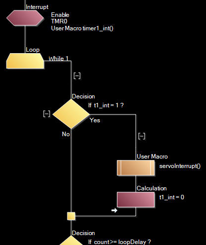

Re: ESP32 Can't sample ADC inside Interrupt Macro
Hi pmgreene01, Hi Martin
I know the IRQ of the ESP32 is not practical because almost all commands in the macro crash.
One possibility, i use at the moment is the following:
I set only one variable(t1_int) to 1 with the interrupt-macro and in the main program I check if it is 1.
If yes i sample the channel and set the variable back to 0.
So I have a more or less a constant sample rate.
For another project I used a PIC32MZ from Microchip. There the interrupt did not cause any problems with flowcode.
Info about main
Interrupt_test_ESP32-02.fcfx
(25.24 KiB) Downloaded 462 times
Post by pmgreene01 »
Thank you for the response. I will play with that approach.
