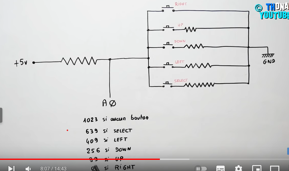

I'm new to Flowcode and I can't find how to read an analog input on an arduino keyboard card.
And display the value of the input.
Capture d'écran 2023-12-10 191150.png (261.11 KiB) Viewed 4522 times

New users are recommended to follow the Introduction to microcontroller programming course.
There is a Potentiometer example here.
That is for Flowcode v10 which I'm assuming you have as you have not used the 9 or 10 post icons.
