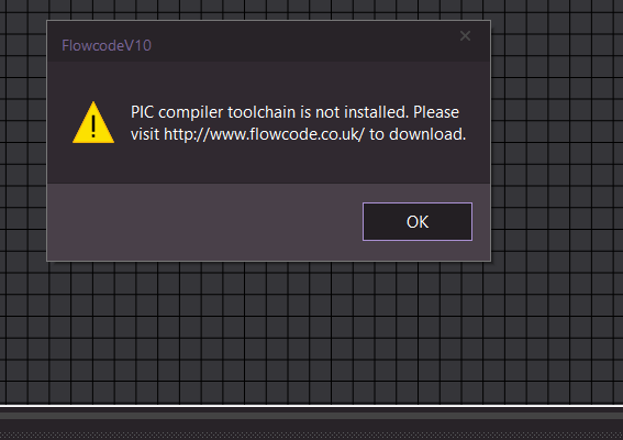

I'm a novice and I don't really understand the principle of the compiler changing flowcode.
I managed to put the Arduino one.
But now I would like to put it on a pic18F87K22 with my ICD4 but it doesn't give me a compiler? yet flowcode is a compiler?
thank you for your help

The download link in the toolbar above contains downloads for all the toolchains. Here is a direct link:
https://www.flowcode.co.uk/download/
For that device, you will need the 8-bit PIC toolchain.

thank you I have already installed but it tells me that it does not have a compiler?

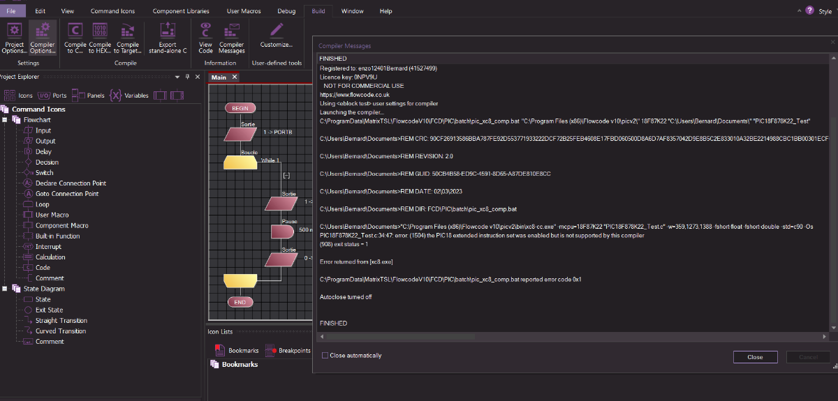

I managed to create a .c file but to send it with ICD4 I need a .HEX point for the "MPLAB IPE" program
because with flowcode I can't send it

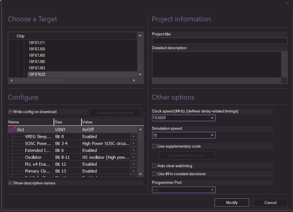

The error is saying the extended instruction set is not supported. You need to change this in the chip config settings (under "build...project options").

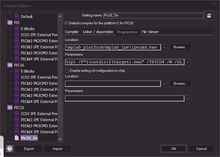

And under "build...compiler options" you can customise the options used when programming the device. The IPE is supported, but currently uses the ICD3. You might be able to change the parameters so it uses the ICD4 instead.

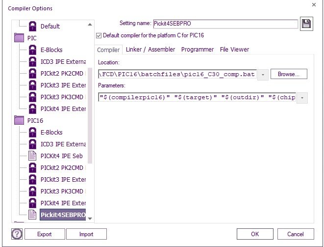

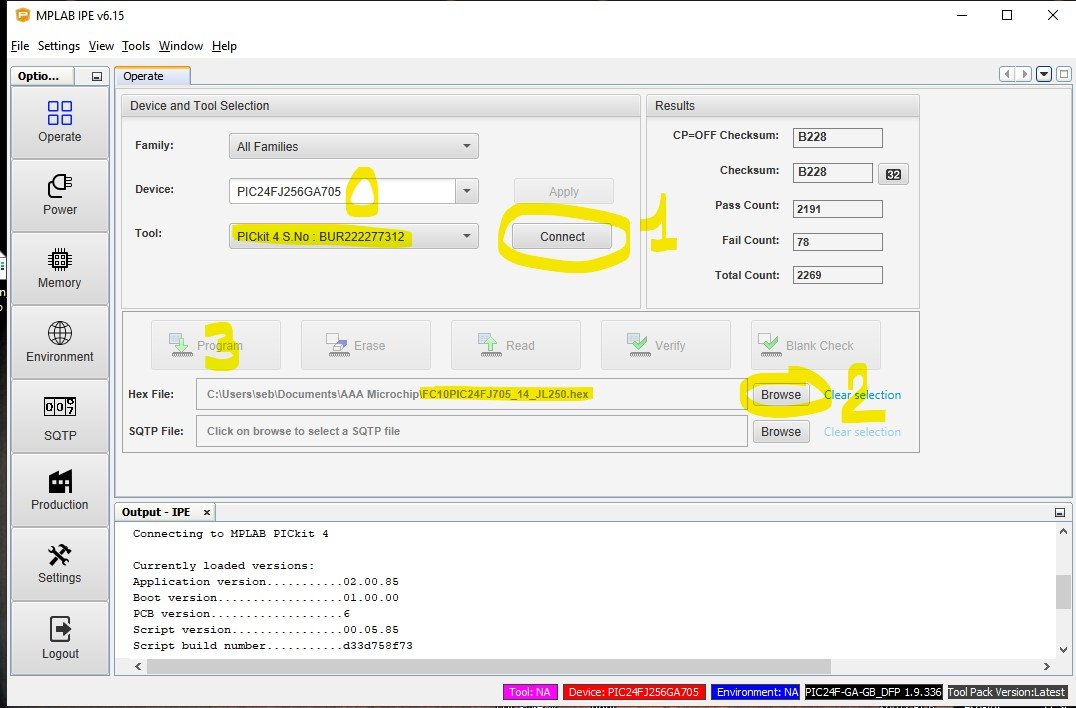

I'm using PICKIT4 but not upload the firmware with FC but with MPLAB IPE who is very fast.
In IPE you only need to load the prog one time then each that you compile it it will ask you to update.

Like Seb, I also use MPlab when I have to programme a serie of devices. It is simply much faster.
It would be a good idea if Flowcode had a button "Flash again HEX" and not compile again
For programming and from time to time to "flash" I prefer the ICD4 and Flowcode.
It's working fine for me with the ICD4 and flowcode with this config.
just use your MPLABX version in the text...
C:\Program Files (x86)\Microchip\MPLABX\v5.40\mplab_platform\mplab_ipe\ipecmd.exe
/P$(chip) /F"$(outdir)$(target).hex" /TPICD4 /M /OL

For info. I use MPLAB and pickit 4. That way if i need to program multiple devices MPLAB opens the same hex file and you just download to device without going to flowcode again. MPLAB reloads the hex file each time so if you have updated it, provided its name hasn't changed, it will download to device the updated hex file
