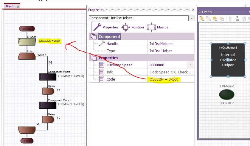

I figured it out. I found the OSCCON register. Now it all works correctly. Thanks for pointing me in the right direction.

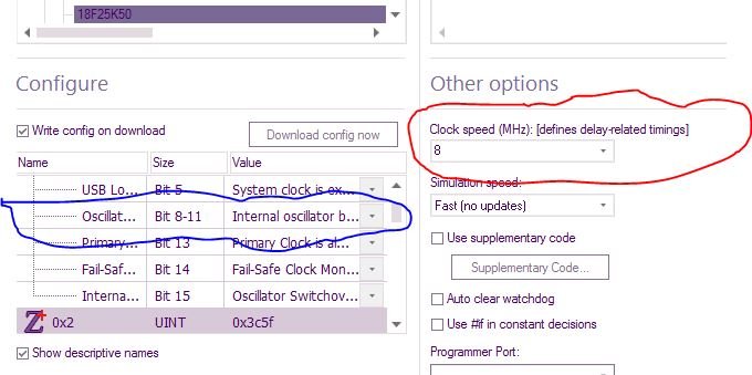

To set the internal osc to 48MHz
Select Component Libraries ribbon and click on the magnifying glass on the far left.
Enter intosc and you will see the Internal Oscillator component within the search results ,drag it to your 2D panel.
To make 48 MHz, we need to run the internal osc at 16MHz then use the PLL within the configuration settings to x 3
Within the properties of the Internal Oscillator component, select Oscillator speed of 16000000.
Copy the Code that is produced i.e. as you will need to add a Code clock at the very start of your flowchart with the correct OSCCON value.
Finally, within project options make sure that Clock speed (MHz) [defines delay -related timings] is set to 48.
Within configure Set top PLL Multiplier selection bit to Output frequency is 3x the input frequency
The next PLL Multiplier selection bit down to Oscillator multiplied by 3 or 4, Depending on the PLLSEL bit
If all the above steps are carried out then the internal osc should run at 48MHz.
