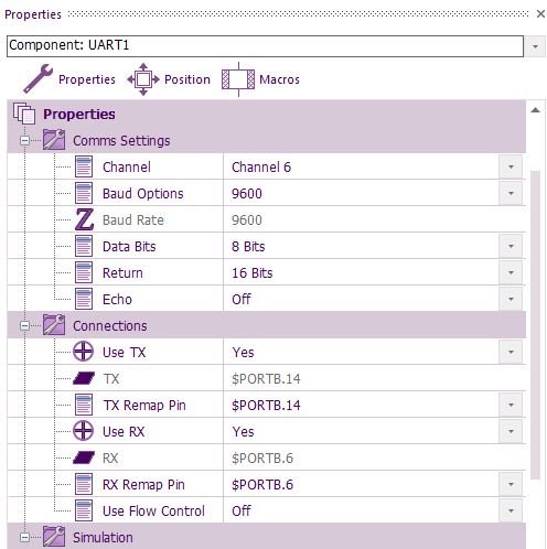

Not sure I understand the issue.
Under properties you can use the remap pin feature for both Tx and Rx.
In the below example I have ch6 on B14 / B6

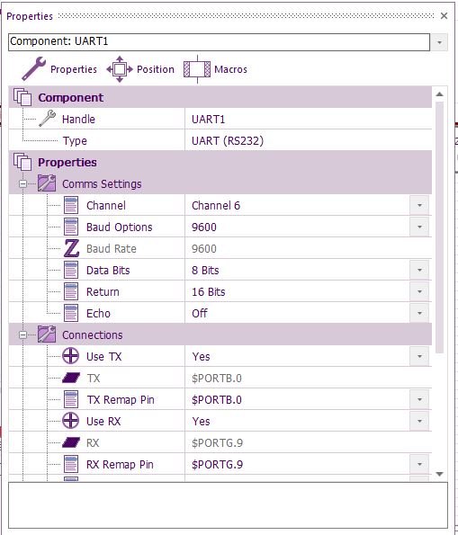

Hi, that works.
I do not have the option of selecting B14 for RX and B15 for TX, for example, but B14 is displayed for TX.
G9, B2, B6, B14, F3, D0, D1, D5 are displayed in both selection windows
When I switch to channel 4, all TX pins are correctly present.
B6, B0, B7, B8, B15, D9, D4, E3.
With kind regards
SpeedPic32
With kind regards
SpeedPic32

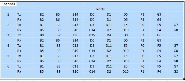

I thought I was going crazy, possibly still do (and am).
I created a new chart with your chip and populated it with the UART component. I then documented my options to remap per channel.
I (eventually) settled on the below
I say "eventually" as when I moved off the chart to populate Excel and returned, I swear the available ports had changed....
Using Channel six as an example, you can see that B0 is not documented anywhere as being an available port, yet when I returned to check for the umpteenth time I see I now have the option.
Each time I move channels then return, my options change too.
Can someone else please check the above and confirm my sanity before the guys in white coats arrive.?

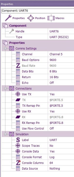

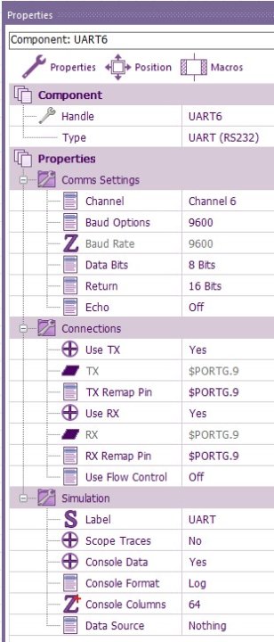

Re: Pic32mz2048EFH064 RS232 Channel 6 Problem
The selection must be made twice at the moment.
Steve has recognized this correctly.
This is of course unpleasant and should be fixed. But what is not possible at all is that TX and RX have the same legs. that is not possible at all. I also know that this is not done, but it is offered, which in turn should not be. The same is not true for the other channels.
See pictures.
See pictures.
