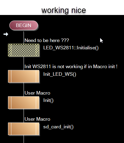

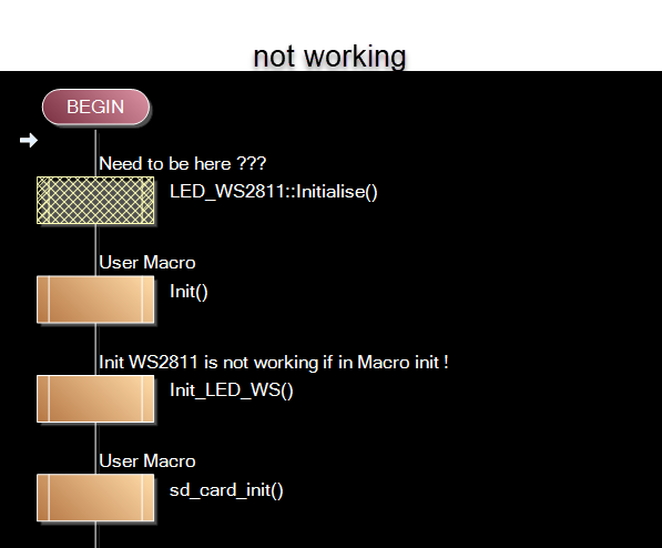

Ws2811 is a RGB Led.
It means that the LED can light up red, green or blue. Compinations can also be made.
Controlled with only one pin from the ESP32. Each LED also has an input and output so that many LEDs can be connected in series.
Flowcode supports this very comfortably with one component.
Unfortunately, for some reason the LED component cannot be initialised in the macro but only in the main.
However, the comands for the colour and brightness can be easily used in macros
Testet 100times....
ESP32 and WS2811: init in macro not working

Re: ESP32 and WS2811: init in macro not working
Perhaps there needs to be a delay or some other code happening before the Initialise() macro is called.
What is within your Init() macro? And does it matter if the Initialise() is at the start or end of that macro?

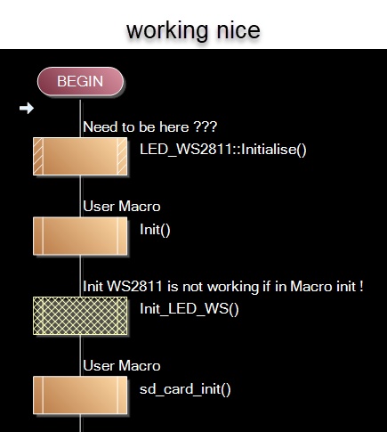

I have tested with delay before and after many times.
But it only helped to put the component init into the main.
Even if I switch from main to macro without or with a delay, it only works if the component init, is in the main part.
It is not a big problem, the LED works perfectly after that.

- Posts: 2061
- Has thanked: 311 times
- Been thanked: 479 times
Also, what if the Initialise() is in Main but comes before the Init() macro? Does it work ok then?
- Posts: 1300
- Has thanked: 246 times
- Been thanked: 258 times
Yes !

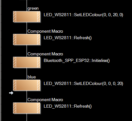

Hi Steve
A problem again with the ESP32 (upgrade?) and WS2811.
on an another board with an ESP32 pico, before the led was working nice. now the led color can just change before init Bluetooth.
After the init Bluetooth, if I set the led to blue, the led is just dark.
If i remove the command to set blue the led is correct green.
This was working nice before....
I use the led mainly to indicate
blue, the bluetooth is working,
green, the recorder is ready for recording
red, recording in progress
Flashing, no SD card inserted
for me it is important that the led works correctly

- Posts: 2061
Sorry, Stefan. I don't use that LED component. I will ask here and see if anyone else has any idea to solve your problem.
