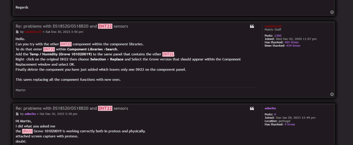

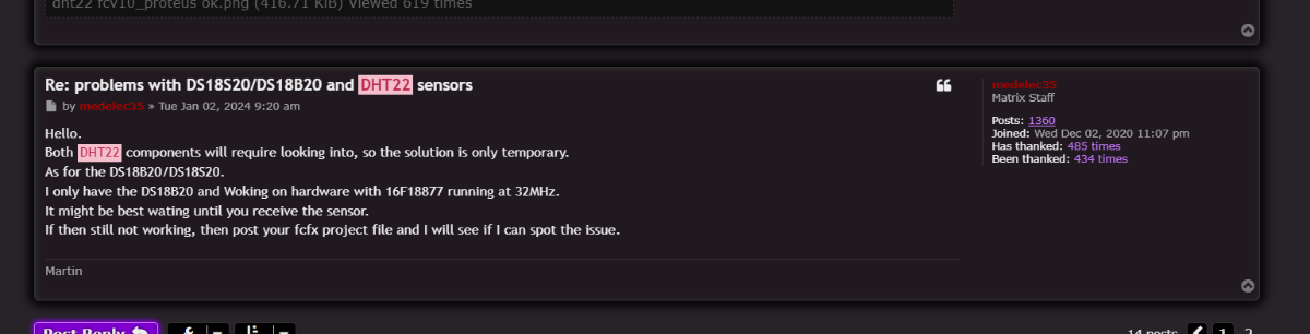

I know tere is an issue with the DHT22, have a look here:
viewtopic.php?f=5&t=2322&p=14224&hilit=dht22#p14224
Until the bug is corrected maybe a try to test Martin´s soloution.. Could be it work with the Lolin :D
Br Jorgen
