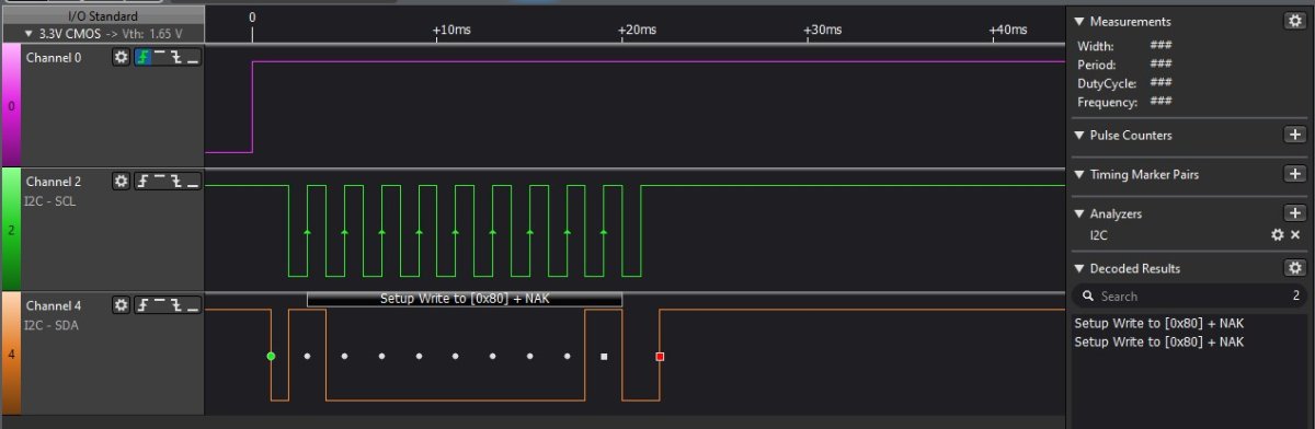

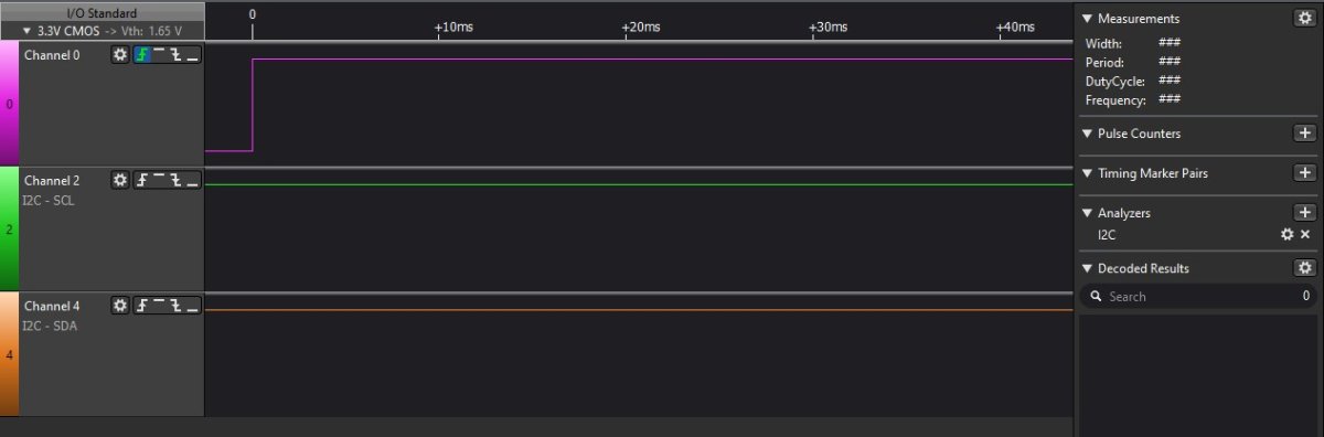

Seems an issue with the component (I2C Master).
Created a very simple chart using I2C Master with SDA on A.16 and SCL on A.17 with 4.7K resistors to 3.3v on the hardware.
I also made pin A.18 go high immediately before any I2C transmission, going low at the end of test.
Using Software chanel I got as expected.
When changing to Ch1 or Ch2 nothing.
