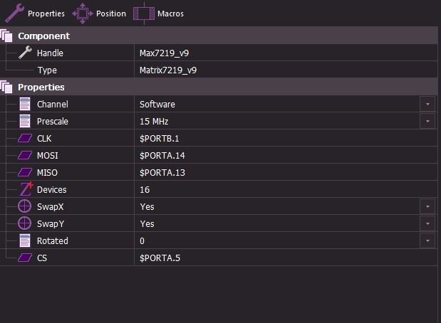

Hello
Just wondering if anyone else has had this happen.
I've been using Martin Fisher great component and it works lovely, it's a fantastic piece of work.
The only problem I'm having, is the connection settings never save, it always defaults back to the attached.
It's not a major problem just wondering what would cause that to happen.
Thanks for any info.
Mark

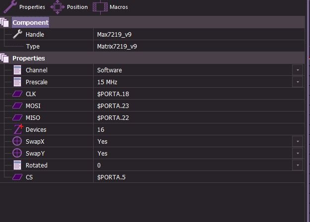

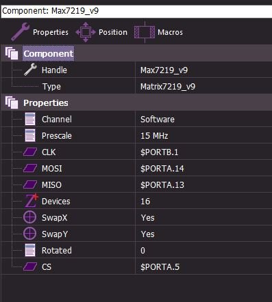

I notice its only the A18,A23,A22 that does not save the rest of the settings save.
It changes the setting back to B1,A14,A13
The A5 saves ok.
