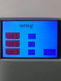

Hi MM team!
I have seen recently that there have been quite of updates on the Ili9488 display. Today I have to update one of my project with this display, Small change, something is wrong with the display. Before these update it work perfect but now it destroy my program, look at the picture.
Fortunately I have a backup of my program, I try to load it in but same issue, after one of these update a bug is comming in, Please :(
IF I ROLL UPDATE BACK TO VERSION 5 IT WORK
Jorgen

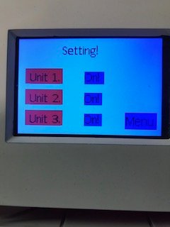

H Ben!
First Congratulations with the new family member :D
Everything look ok again with update 21, but now the display i extremly slow? now also with V.5 sorry,
* EDIT, WORKING I WAS TO FAST. I HAVE TO RELOAD MY BACKUP PROGRAM, PERFECT BEN, THANK`s* :D
