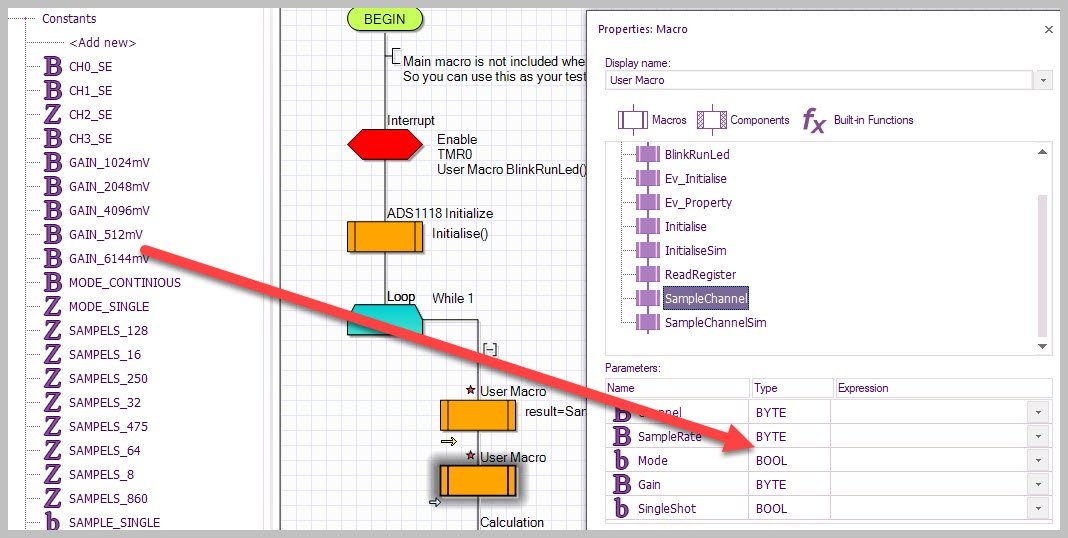

Hi Team.
I am struggling with the scope visibility of Constants I will appreciate any hints or help.
On the ADS1118 ADC there is a complex setting /configuration possible and to make a component that supports all these configurations it is necessary to define them and allow the user of the component to select these various settings , ,
At the moment I have these settings as CONST in globals and then pass them into the macro call as shown below.
The question is there a more elegant way for example include them with in the macro and then when the macro is called the user can select them with the .XXX syntax.I tried but was not successful (maybe I miss something) .
Also if the CONST are in Global s will they get exported with the Component, when exported ?

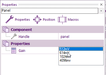

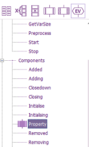

What about adding it in properties?
You just select Fixed list of ints for the properties type.
As soon as a property selected, the Property in the EV part is automatically accessed.
So you will just need to enalbe it.
Of course that will only work if only one gain is needed?

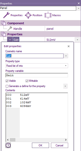

Another way is a number selection.
0 for 512mV, 1 for 614mV etc.
The number values is added to the decription so the user knows which one to select.
Like this:

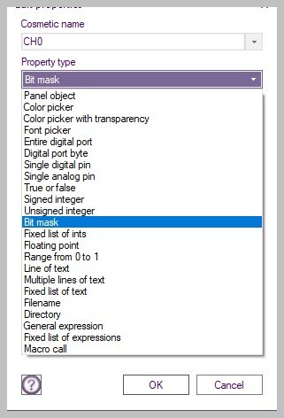

I like the property way as it use names and a person can clearly see what you select.however it seems
that selecting a byte type is not possible in the list of variable types. What I actually need is a byte type(because it is a mask of size byte ) to mask out the corrects settings.
the closes I can see a Bit mask which allows me to tick on the value I would like for the mask but my concern is that it seems it is a integer variable type showing a Z next too it
What would have been ideal for me if there was a list of bytes :D just a fool can wish such things :D

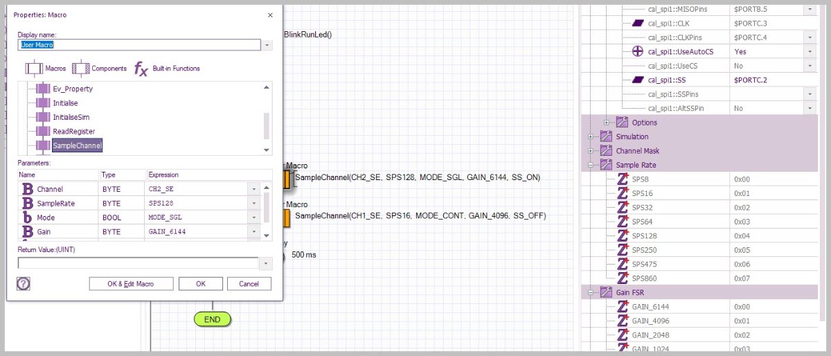

As Martin suggested I created properties and the properties contain the Mask for the Configuration register ,this works nice I am just not sure if this is an elegant way any comments on it is appreciated.
Calling the Macro and the Setting the properties as parameters result in the correct configuration for the Channel :D and the call is readable you can see what channel , Mode ,Sample Rate and if it is a single Conversion or Continuous Sampling

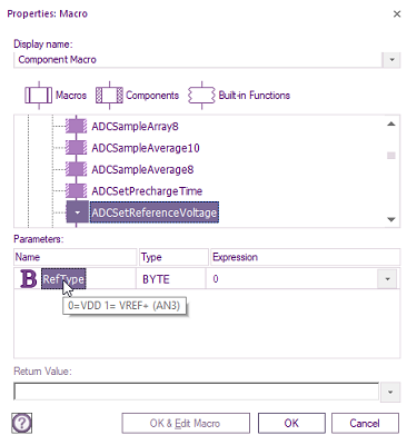

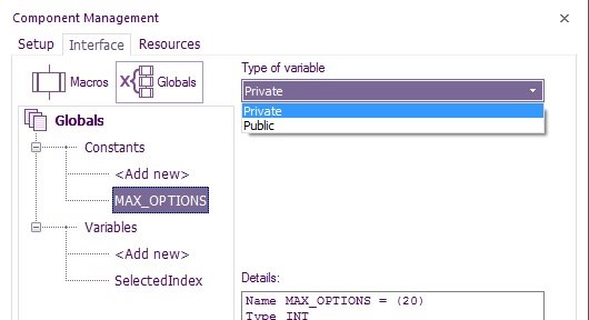

It is also possible to make constant values available to the user by going into the Interface -> Globals tabs of the Component Management window.
Just set the Global constants / variables to public and they will appear as options in the parameter fields for component macros.

:D
Thank you Ben this is also valuable information :D

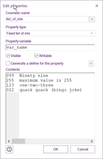

You could create a "fixed list of ints" property and then change the numbers on the left of the list. The property variable ("var_name") would equal the value, not the text.
