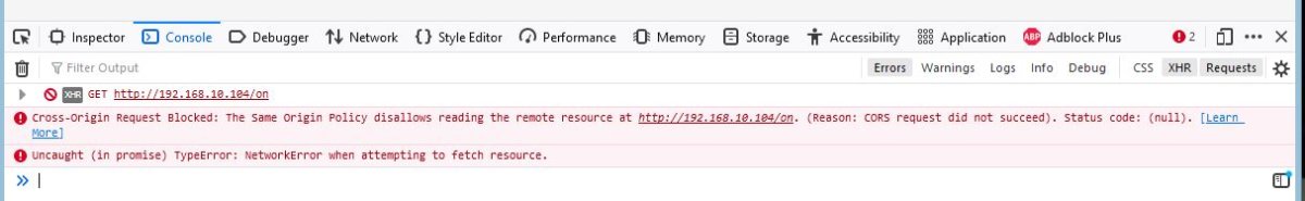

Firefox v115 is the latest version that runs on W8.1 and v123 is the latest running on W10 / 11. All instances of FF are identical in terms of settings / add-on etc.
The issue in using the Example in FF v115 relates to CORS, but although going through the help files I've not yet found out why (probably just too dumb).
Using MS Edge it works fine in W8.1 though.
My phone runs android 13. It appears that the default for opening HTML files is HTML Viewer and this doesn't allow the Example to work. Although Firefox is the default, I couldn't find a way to open the file with anything other than the Viewer. "Open With" gave no options. Downloaded DuckDuckGo and Chrome and "Open With" then gave options for Viewer and Chrome. Using Chrome the file worked.

I'm surprised about the CORS issue in FF v115. Are you saying the same app works fine using another browser on the same device, but throws a CORS error if using FF on that same device?
When running other browsers, especially older or mobile-only versions, you may run into compatibility issues with the code and html in the deployed apps.

Hi Steve
Exactly that. On my W8.1 FF throws a CORS wobbly but Edge is fine.
On my android, not found a way to get FF to "see" the file yet, but Chrome does work.

I've had a quick look and there are others experiencing similar issues. For example this one says it could be a certificate issue or an issue with a browser extension.

I tried disabling all extensions, didn't work, then compared my 115 settings to 123 and all my FF instances are set the same.
It's not going to be much of a issue for me, as Edge works. I might try with some other browsers just to see which if any are troublesome..

Further info.
Firefox 115 on a W8.1 machine doesn't work due to CORS restrictions. Microsoft Edge and Google Chrome do work.
Firefox 123 on W10 / 11 does work as do Microsoft Edge and Google Chrome.
On a Samsung running android 13, Firefox, Chrome and DuckDuckGo do work, however default app Web Viewer does not. Depending on your chosen File Browser you may not get an option to open the HTML file with anything other than Web Viewer or Chrome. File Manager + available from the Play Store does give you all available options. I'm sure others do too.
On a WileyFox running androd 8, Firefox and Chrome both work fine.
I'll update when I try with other OSs etc.
Further info.
