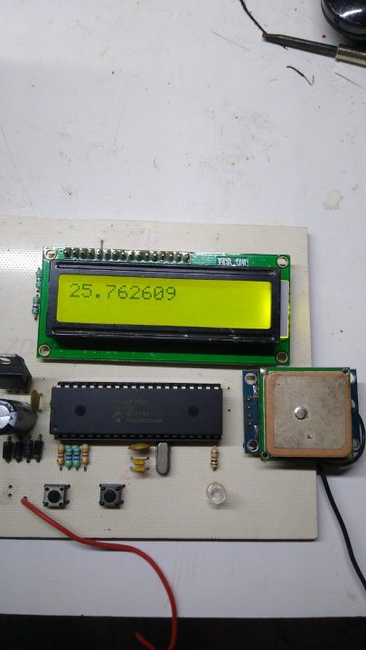

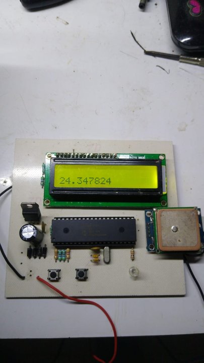

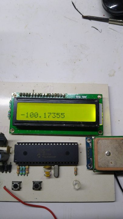

Hello Chipfryer27,
in the simulation it also sends numbers different from those recorded in the EEPROM, it sends images of the numbers recorded in the EEPROM and later read; The number recorded in address 0 changed the value when it was read, the number recorded in address 1 remained the same.
Enrique
Enrique
- Read1.jpg (38.51 KiB) Viewed 6099 times
- Write1.jpg (42.79 KiB) Viewed 6099 times

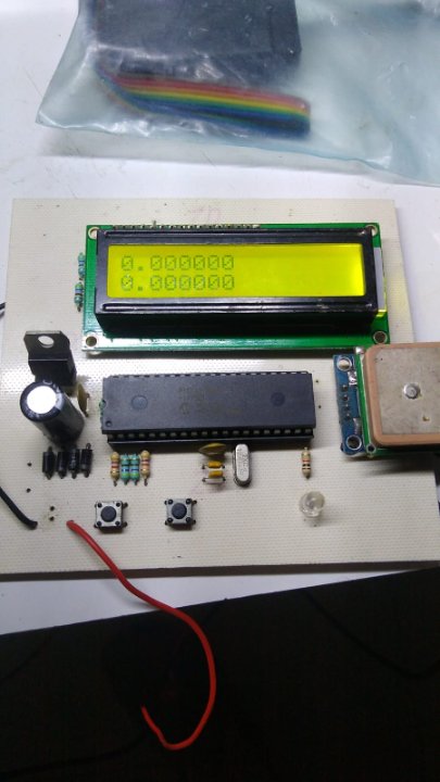

I'm just waiting for the GPS to connect so it can show me the coordinates and do the tests. Flowchart shipping.
- TEST1939v10a.fcfx
- FLOWCHART
- (26.63 KiB) Downloaded 695 times
- GPS.jpg (44.06 KiB) Viewed 6080 times
