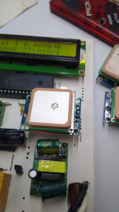

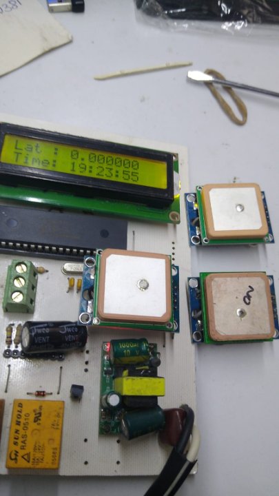

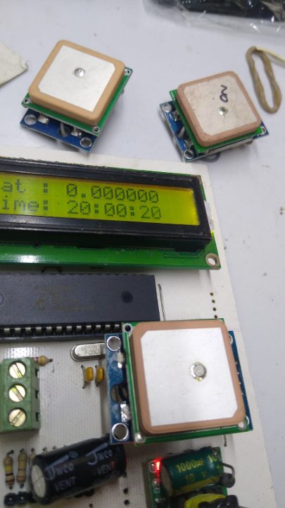

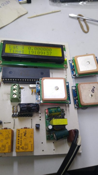

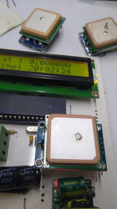

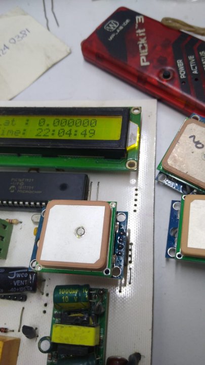

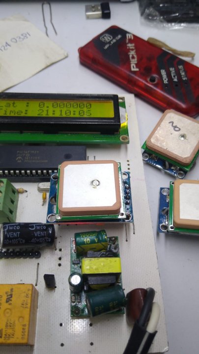

I have been testing with GPS, I don't know what it consists of, I have previously made designs that are working to this day with the sending of coordinates, hours, minutes, seconds in real time; but now with flowcode 10 I cannot receive LATITUDE and LONGITUDE, I bought 2 new GPS and I have some used in other tests; Now to avoid failure, use the example published in Flowcode 10 (GPS_TEST) send the LATITUDE, Hour, Minutes and Seconds; If it sends me the Hour: Minutes: Seconds, but the LATITUDE: 0.000000 is not sent; Apparently there is a connection to a satellite, but it does not send the coordinates; On rare occasions I receive LATITUDE and LONGITUDE, but it returns to 0.000000 or the wrong coordinate; Right now I've been waiting for the reading for 3 hours, and it only sent me the time (it takes 2 or 3 minutes to send it); Yesterday I had the circuit on for more than 8 hours and I couldn't get it to send me coordinates; Could you take a look at the GPS component or see what the fault could be ? :?:
I send the example and circuit with reading.
Enrique

I disconnected the circuit and reconnected it, it took 5 minutes to send me the time; but LAT I still haven't received the data.

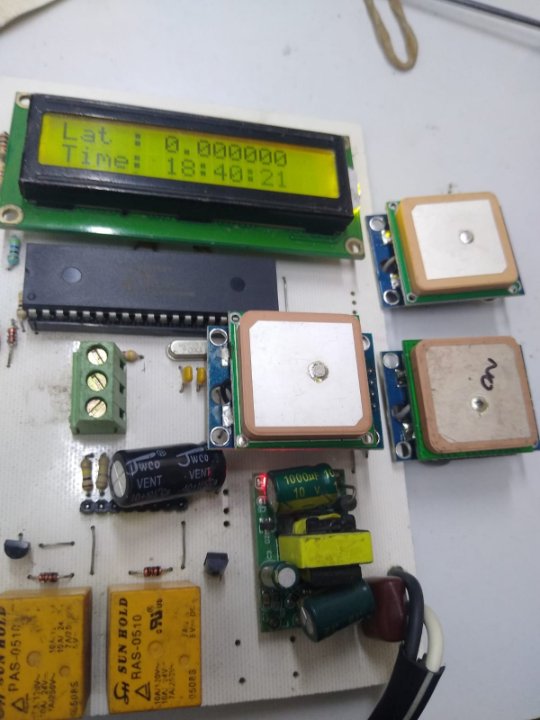

The circuit has been connected for 7 hours without sending LAT, but the time is sending it without problems.

Hi!
I have the same setup HW as you. I make a test later today and see if I get the same result with your program.
You hear :D
Jorgen
jgu1
Posts: 976
Location: Denmark
Has thanked: 910 times
Been thanked: 220 times
Re: GPS not send LAT_LONG
Post by jgu1 »

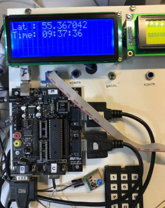

Hi again!
I have change the device to a Pic16f1937 (not big difference) and change the pin config for the display. Get same result as you.
Then I make some test with "buffersize" in Properties for the GPS. Set it from 80 to 50, then it work perfect for me.
Try to change this :D Hope you get succes?
Br Jorgen
