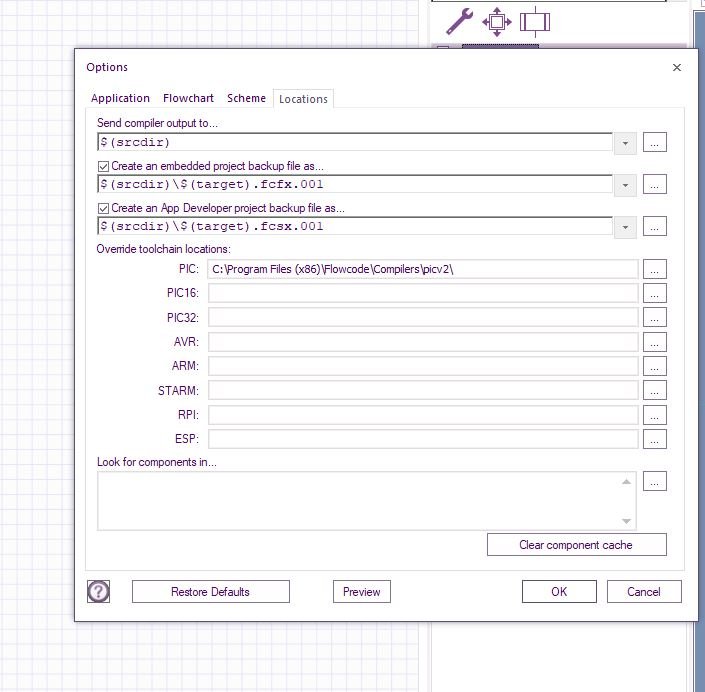

Hello, I need some help with compiling my first project. I have installed the flowcode 9. I 've then installed toolchain for avr /arduino. I 've opened again the project and I 've tried to compile to arduino. There is a message
AVR compiler toolchain is not installed. Please visit ...flowcode.co.uk to download.
Can you please help?
Thank you

Re: Avr Compiler Toolchain problem
there is no path at all.

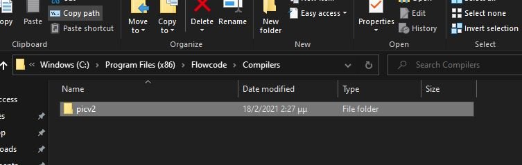

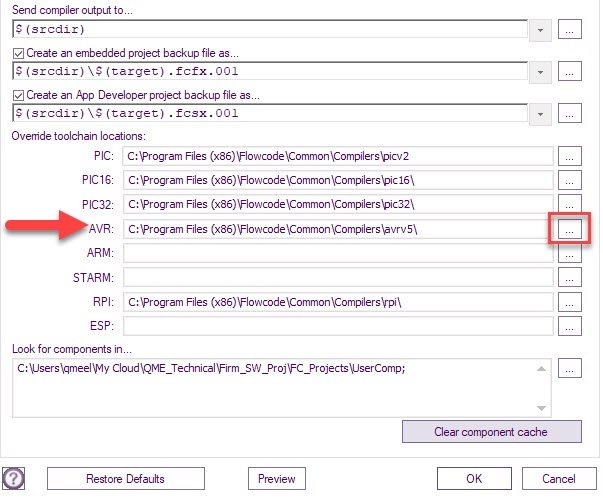

It should look like this
Are you sure the tool chain installed ?
Try to set the path with the button

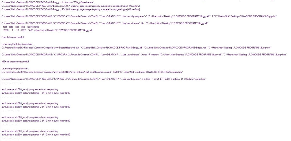

Thank you very much the problem was resolved , it was the global settings after all. But most of the times when I'm trying to upload a program to my arduino this message appears.
Hi Sorry to say but we can not read anything on the picture you posted can you try again with a better resolution
If you download it and see it in full screen, you will see it better

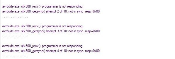

nickchlapout
- Posts: 12
- Joined: Sun Feb 14, 2021 8:07 pm
I am sending you the main problem

nickchlapout
- Posts: 12
I am sending it now
Is COM4 correct for your Arduino? If not then try going into the Build -> Project Options menu and ensure you select the correct port for your Arduino. Even if the setting looks correct make sure you click on the setting and double check as there is a known bug where Flowcode will list the first valid port even when no port is actually selected.
Out of interest which Arduino are you using? Do you have the port open in any other software?
