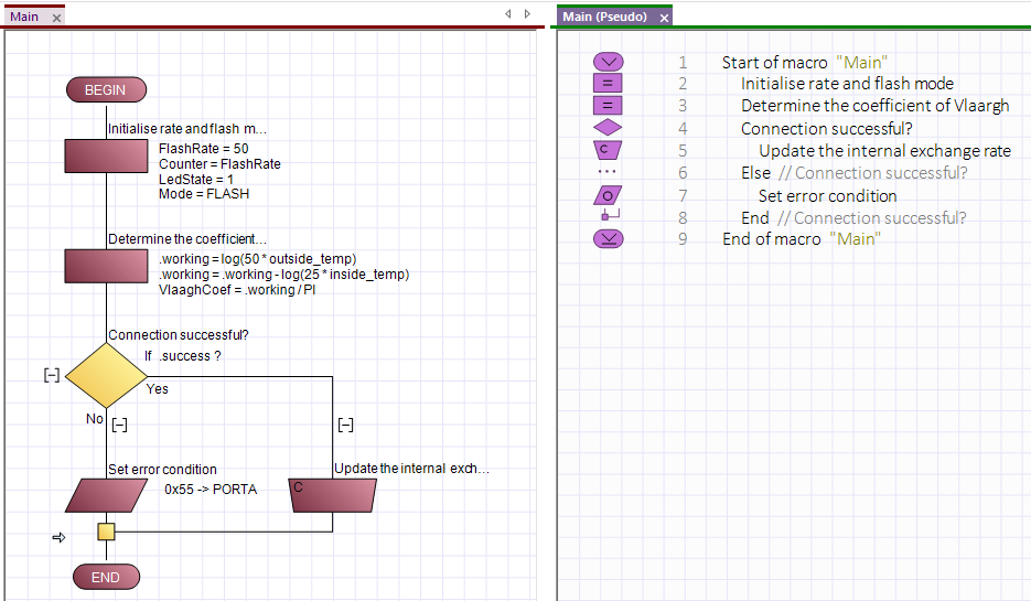

One of the changes in this latest release that may require a bit of explanation is the new "display name" text mode for the Pseudocode views. This setting can be found in the "Non-flowchart" tab of Global Settings.
When this mode is used, the Pseudocode view simply outputs the "Display name" text for that particular icon in the macro. By default, these will be fairly unhelpful and contain text such as "Output" or "Loop". But when these icon entries are modified (via icon properties), the Pseudocode view can become a useful way to see a top-level description of the macros in a Flowcode project.
This image shows a simple flowchart and its equivalent Pseudocode display when this setting is used:

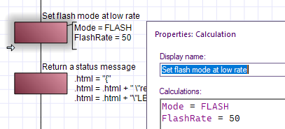

The "display name" entry for each icon can be found in the icon properties windows:

These lines of text in the Pseudocode view can be dragged around and double-clicked to edit them, just like in the other views.
The other Pseudocode options include the original "pseudocode" view which attempts to automatically describe the icons. There is also a "verbose" mode which gives a lengthier text description of what each icon is doing.
