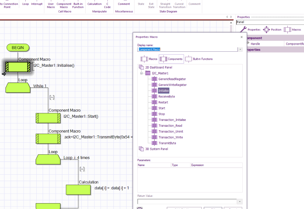

I created a simple demo that uses the i2c master and slave components.
I have the master as an Arduino Mega and the slave as an Arduino Nano - but this should work with any combination of boards.
Connect SDA, SCL and GND (a common ground is essential) I also added 10k pullups on SDA and SCL - but after getting things working I removed them and nothing seemed to break
I also connected an oscilloscope (logic probe) with i2c decoding to help develop and debug the code. This was especially helpful checking for ACK/NACK (and I'm not sure I really understand the 'mask' property in the slave code.. I use 0 - which should match any address (I think?))
So - a rather 'rough and ready' example - the Nano (slave) receives the address byte sent by the master and then 4 data bytes (and it outputs these to UART) The master just outputs an address, followed by 4 data bytes (which are incremented by one each time) then delays for 1s and repeats.
I initially tried to output 'last byte' as true to stop the master - but didn't succeed - so here it just uses a loop counter. Looking at the trace - it seems to output ACK - even when last byte is set to true. This might be a bug in the component (or my code?)

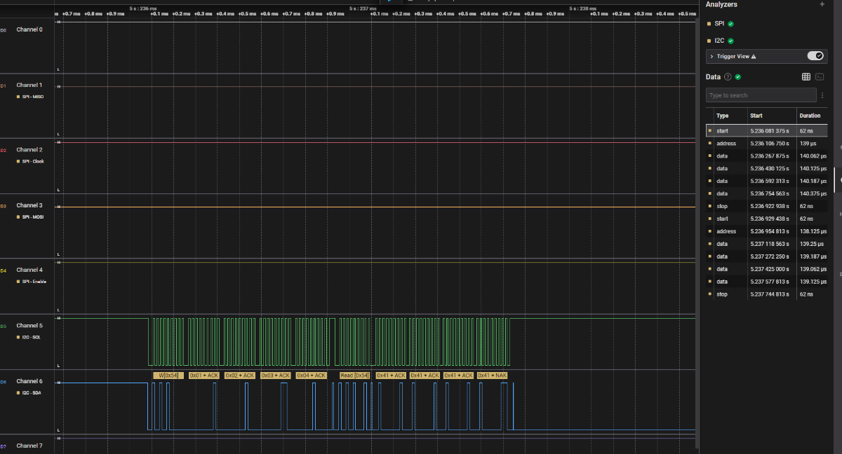

I tested your codes and they work as you can see from the screenshot, thank you very much, I wanted to ask you: why does the cycle not repeat every second but only once?
what is the difference for example between initialise and transaction_initialise? What function do transactions have?
if I also have to send data from slave to master and not just from master to slave, do I have to first save these in registers in the slave and then query with the master?

It's odd that it just worked one time for you - repeated every second for me. Strange.
Initialise is needed before using the i2c (once only), the transaction routines allow a simpler interface (it handles start and stop conditions. Transactions are also the only available interface on some MCUs but that doesn't affect us here)
It should be possible for the slave to reply with data (master issues a read request) This is typically used to read values from sensors etc.
I'll have a play this evening and see if I can get two way comms working.
Note that the only real difference between master and slave is that the master initiates transactions ( by issuing 'start' ) - so in the case of two MCUs the roles could be reversed.

Re: 2 Arduino I2C communication
yes Martino usually only does it once a few times 2 max I've seen 3, and to start it again I have to press the reset button

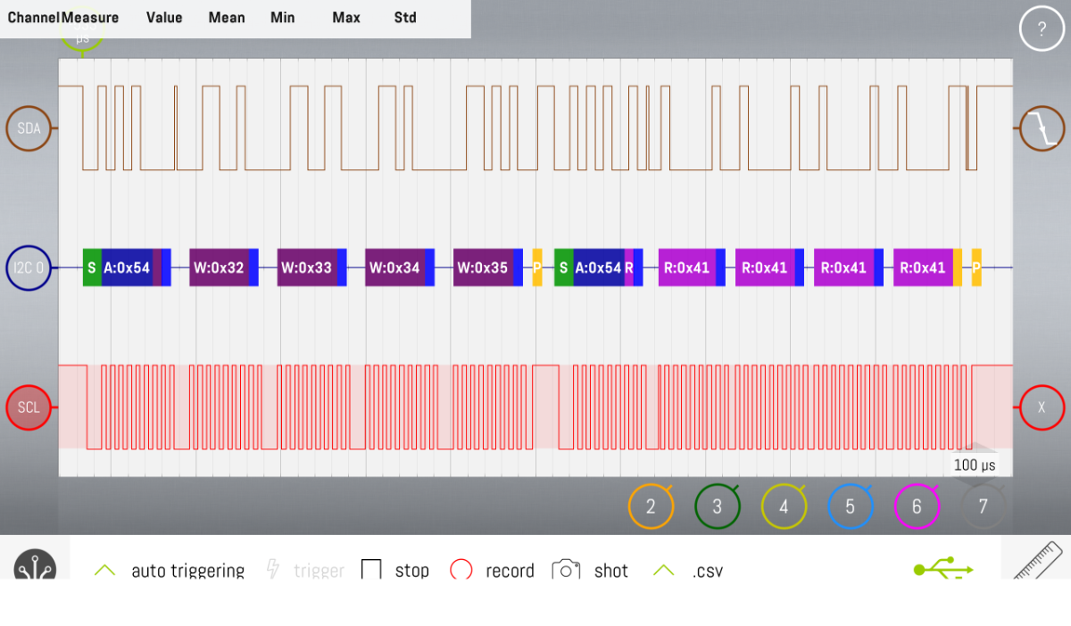

I've had one step forwards and one 'to the side'
So - having ascertained that transmit works AOK (for me
) I rewrote the code to use the I2C CAL component and transactions )notice how this makes the code for the master much simpler) I also just use the scope here (and as smartscope has decided to crash on my PC I had to call in a tablet to run it (nothing going well today!)
I then added a 'read' that attempts to read 4 bytes This - sort of works. I tried with a loop - and also 4 individual calls to write - but the trace shows that the master just receives the same 4 bytes (first one sent!) However - I note that it does set ACK/NACK correctly..
So transmit works well (this on hardware - I haven't tried simulation) But receive (unless you want a single byte) doesn't. I suppose it would be possible to reply with individual bytes per read request and maintain a counter in the slave - but a bit of a kludge.
Not sure why this is happening - I tried a small delay after each byte and also using individual commands (start - tx, etc) without joy.

hi Martin, I tried the 2 codes and I get the same results as yours except for the fact that the loop does not repeat and therefore I only see the data exchange once and not every second, maybe if someone else has 2 Arduinos and 10 minutes of time could do a test and post it, if it works it won't just be a Byte to exchange but a few more, it depends on how much I want to exploit the 328 for calculations
thank you
