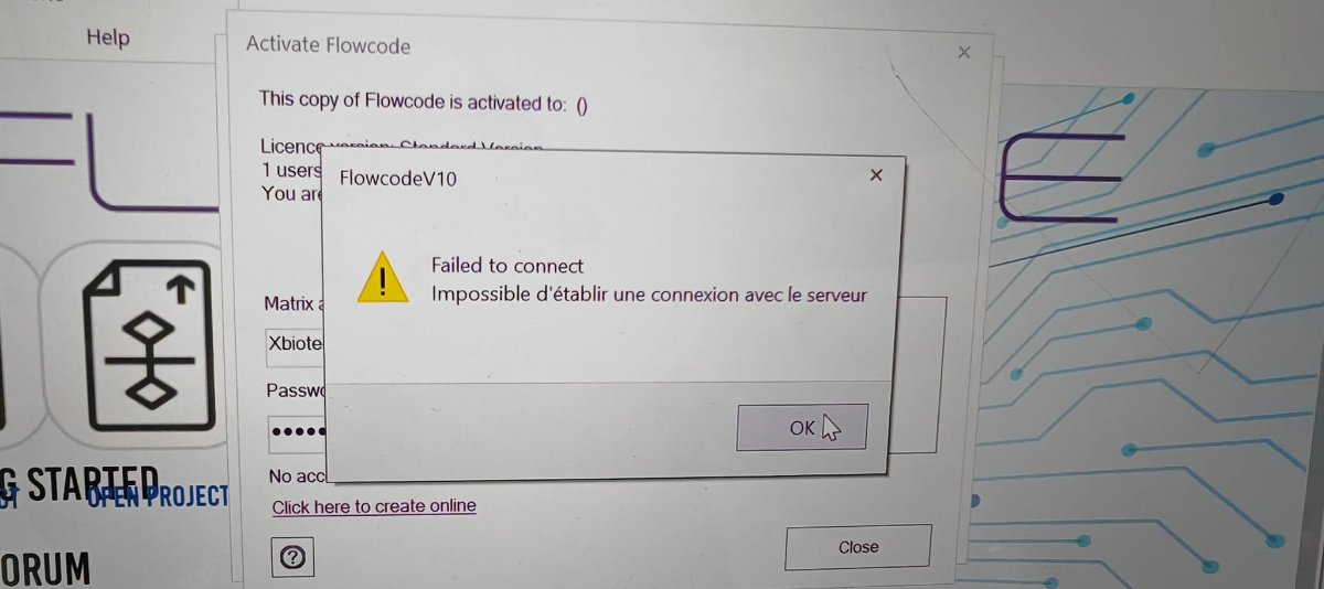

I just installed FC00 on my laptop and cannot activate it with the license
the line in French mean: "unable to establish connection with server"
Labtop Failed to connect.jpg (71.04 KiB) Viewed 5146 times
Win 11 + ESET
have you ever had this type of problem and how to solve it?
Thx for your help

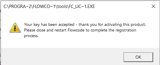

I have just tried and can activate Flowcode.
Key accepted.png (13.44 KiB) Viewed 5132 times
at least that is showing the issue is not with Matrix servers.

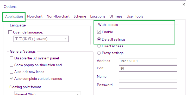

For some reason Flowcode is being blocked by a firewall or other third party from communicating with the matrix servers.
Within File > Global Settings, can you check the following settings match:
Global Settings.png (26.36 KiB) Viewed 5132 times
Do the library updates work ok or report a connection error?

This appears to be a "ERROR_INTERNET_CANNOT_CONNECT" message that is created by Windows. Searching the internet, I've found posts that show Windows Defender can block internet access and cause this error be be created.
You could try looking at the logs of Windows Defender and any other anti-malware apps you have running to see if they are blocking "FlowcodeV10.exe" or the "fc_licensing.exe" app. You could also try creating exceptions to allow those exes through the firewall.
after first install of FC10, I can not access to : File > Global Settings.
when FC10 start it open directly the page to add the licence
