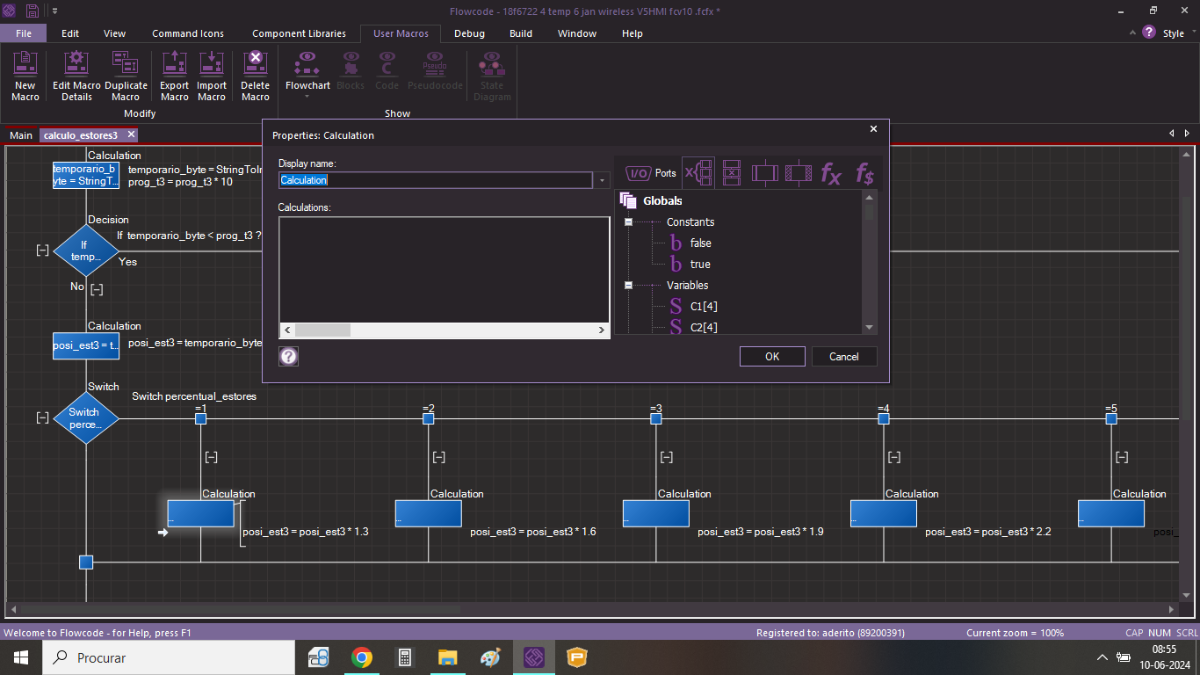

Hi guys, today I found something strange...
in some of the macros the calculation icons are empty.....
- Sem Título.png (242.17 KiB) Viewed 7106 times

Thanks Steve, I'll try to fix it.Steve-Matrix wrote: ↑Mon Jun 10, 2024 9:42 am
Thanks for the report. This is a known issue. Please see here:
viewtopic.php?p=16083#p16083
- Posts: 2061
- Has thanked: 311 times
- Been thanked: 479 times
Re: error when compiling with fc 10
If you have opened a calculation icon and seen the text missing and then clicked "cancel" then the calculation within the icon will remain. But if you clicked "OK" then the calculation will be replaced with the blank text.
However, either situation should not cause an error when compiling. That is likely to be a different problem.
