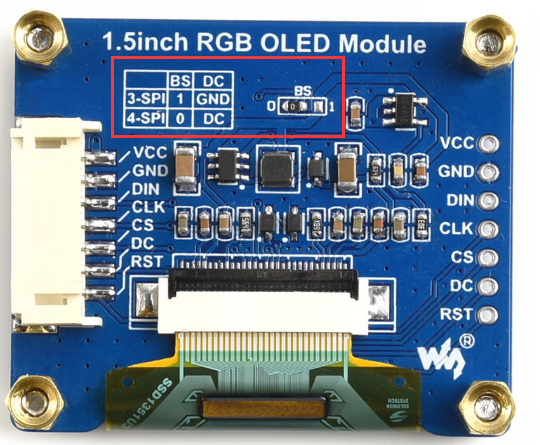

I have the following request
I urgently need a driver for this controller SSD1351 Specification Operating voltage: 3.3V/5V(Please ensure that the power supply voltage and logic voltage are consistent, otherwise it will not work properly) Support interface: 4-wire SPI, 3-wire SPI Controller: SSD1351 Resolution: 128(H)RGB x 128(V) Dimension: 26.855(H)x 26.855(V)mm Pixel size: 0.045(H) x 0.194(V) mm Display color: 65K color: 0.005(V)
https://www.waveshare.com/wiki/1.5inch_RGB_OLED_Module

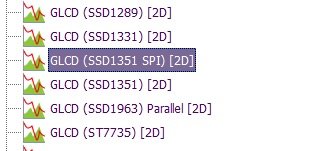

We have a component for the SSD1351 already which should work fine. If you have any problems then let us know and we will investigate.
Connect the Flowcode RS pin to the pin marked DC.
We've recently been working on this wiki page with lots of useful GLCD related information https://www.flowcode.co.uk/wiki/index.php?title=GLCD
