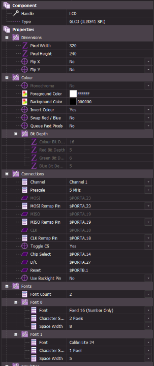

I used the display on this hardware with an ESP32 and it's working nice with flowcode.
Core 2 with touchscreen: M5 Stack Fire (with Button) and about 50 $:
https://www.mouser.ch/ProductDetail/M5S ... DFJA%3D%3D This is the setup for the display:

Hi Stefan,
It will likely update the display a lot faster if you enable the Queue Fast Pixels property.
