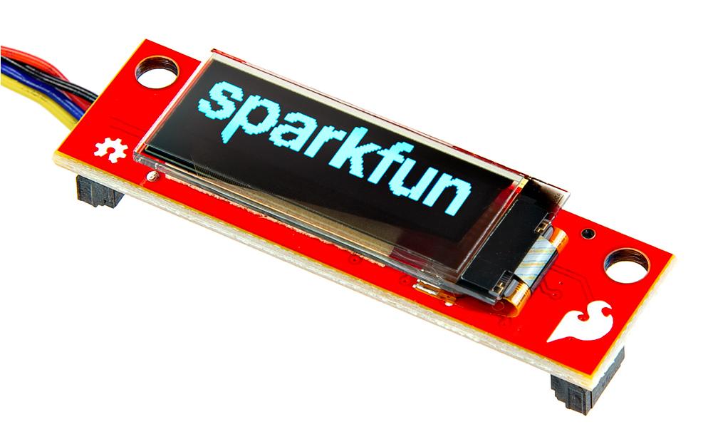

This display is working fine with Flowcode.
Thanks to an I2C command structure, the board's firmware maintains speed by updating only the part of the screen that changes. Computer graphics use this concept with "Dirty Rectangles" or "Bit blit" operations
or
Queue Fast Pixels
Is it possible add one of them to the component?
https://www.sparkfun.com/products/24606

Re: ESP32 I2C Oled Display 128x32 with SSD1306
Yes, I use this display with the ESP32.
The display is very bright and very comfortable to read, if the text is static.
It works on 5Volt and 3.3Volt. I can recommend it.
Only the text in the display is built up letter by letter, like slow motion.
That is not so pleasant.
The display is used by various manufacturers like adafruit or waveshare and more
https://www.adafruit.com/product/4440
or
https://www.waveshare.com/product/displ ... module.htm
