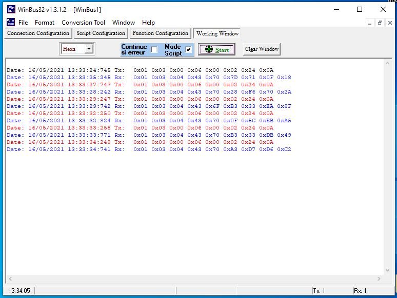

using winbus to read L1 Volts
period 500
send 2 3 0x00 0x06 0x00 0x02
Date: 04/03/2021 18:45:28:877 Tx: 0x02 0x03 0x00 0x06 0x00 0x02 0x24 0x39
Date: 04/03/2021 18:45:29:378 Rx: 0x02 0x03 0x04 0x43 0x6D 0x05 0x1F 0x0F 0xF2
using - 43 6D 05 1F = 237.02
scadacore's online convertor confirmed that the value is correct

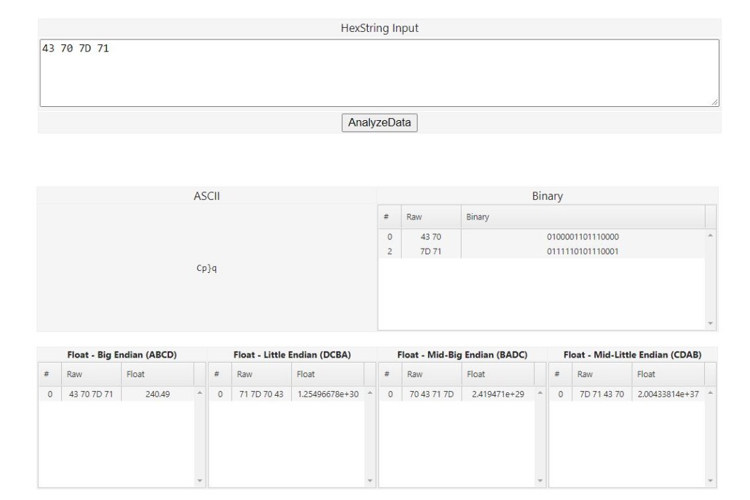

:Edit - my attempt added - didnt work, tried to follow an example i was looking at and modify it to suit.
Float Big endian result is correct
not sure how 240.49 was obtained as adding the results together in HEX, then converting back to DEC gives 415 (on a calculator)
and adding 43 70 & 7d 71 together in HEX, then converting back to DEC gives 49,377 (on a calculator)

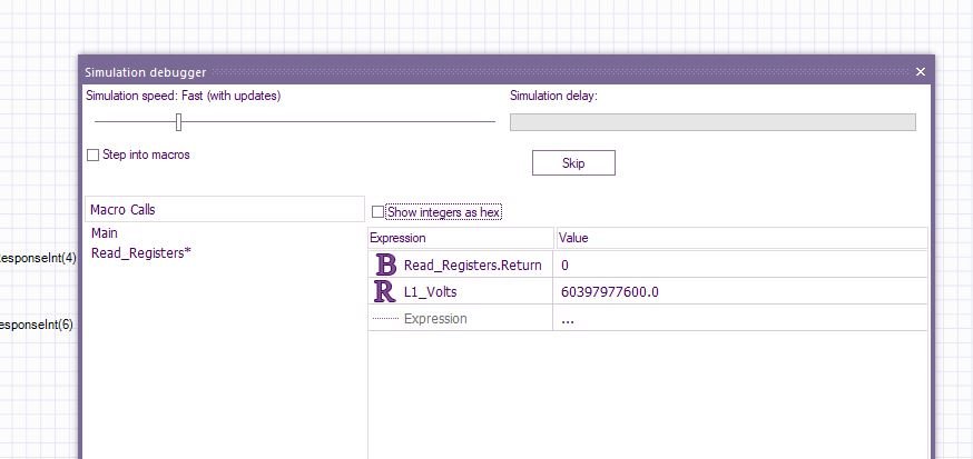

This is the result i get ?
Volts =245.7
Steve

If you look at the console window it should show you the data that is being received. We can then try ad figure out what isn't quite right. Maybe we aren't assembling the float quite correctly? the ints or bytes within the ints might need to be rearranged?
