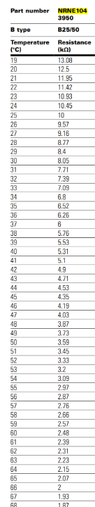

it is very comfortable to insert the few values according to the temperature.
These values can already be found on very cheap NTCs like this one
https://www.mouser.ch/ProductDetail/Bu ... ulQ%3D%3D
On page 7 the complet list
https://www.eaton.com/content/dam/eato ... x1226.pdf

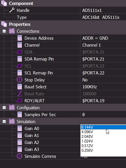

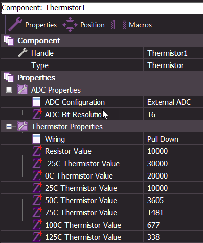

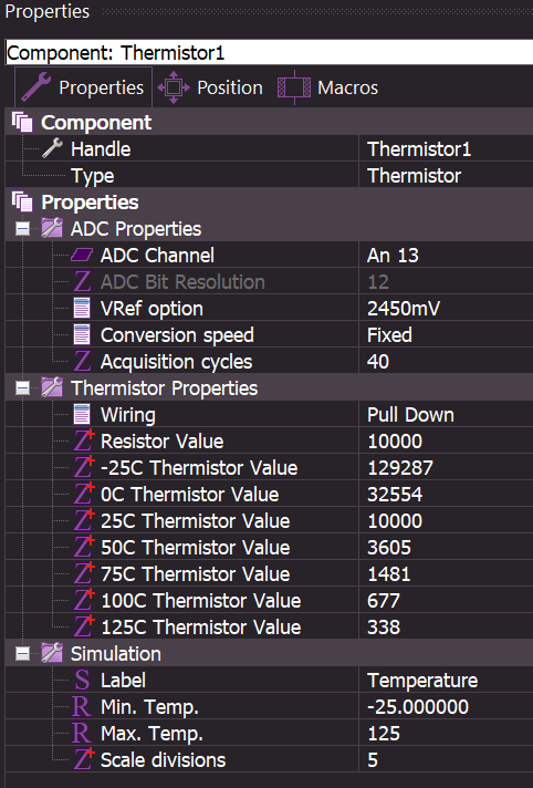

On my ESP32 Wroom i get a fail if I choose extern ADC (no fail if intern).

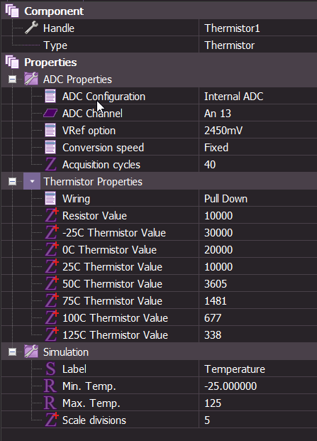

One more question. With the internal ADC I can (must) select Vref
I can't with the external ADC, but I have different gains with the ADS1115.
can I use a specific one?

vref internal:
vref external:
ADS1115 Gain option:

Thanks for letting us know, Hopefully compile error with external mode now fixed for you.
The thermistor component assumes that you have the full resolution of the ADC so the gain probably needs to reflect this too, I imagine it's the lowest setting you need but I could be wrong.

I have still the fail compile error with external mode.

I can compile with the thermistor component now.
There are still little problems:
When I set the component to 16 bits, save the program and load it again, the bits are set to 12 bits again.

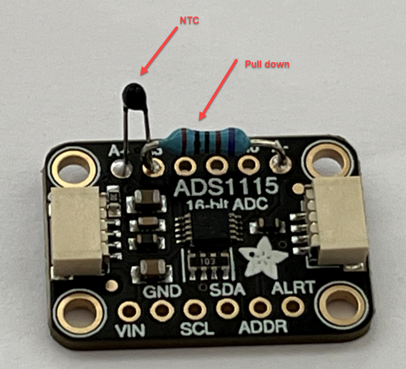

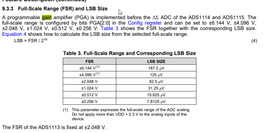

This has such special Vref settings and never delivers a signal above 32767. With this value I only get 25 degrees or less.
I can set the NTC supply voltage with a lab power supply, but more than 25 degrees (32767) is not possible. No matter what Vref I set
Would it also be possible to use the NTC supply voltage about 3.3 volts or would it be adjustable independent from the Vref of the ADS1115?

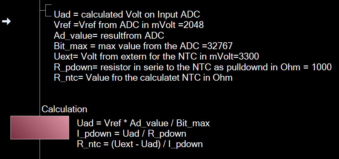

I found the problem from the ADS1115, it's just to 32767 possible.
Single-ended signal measurements, where VAINN = 0 V and VAINP = 0 V to +FS, only use
the positive code range from 0000h to 7FFFh
So calculated the value fron NTC resistor
It working nice but I need a component
which has the resistance value as an imput and the table with the 7 pairs of values.
There can also be more than 7 pairs .
This component could also be used not only for temperatur but also for other values such as a pressure sensor
where I have 20 different calibrated values, every 25 Newton a value up 500 Newton
I calculated the value fron NTC resistor like this
