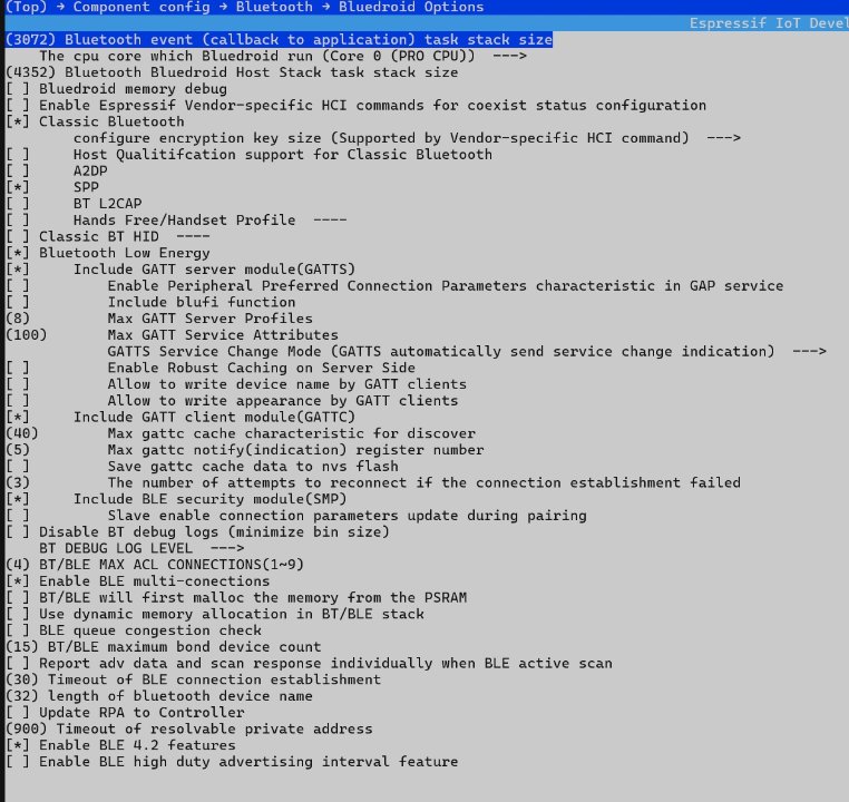

Here's is what I follow on getting mine to work. Follows these and you will work it out
>> On the BLE Configure image below mine is slightly different. I just follow what is there.
>> I then Read what BenR said
I save the image and then Copy the text to my laptop. For Future use like now.
The new batch file once run using c.txt
(990 Bytes) Downloaded 341 times

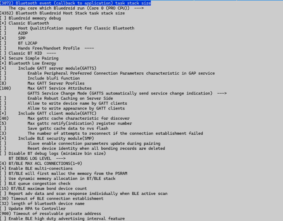

hi
This is how mine looks, just copy what is there.
Screenshot mine.png (193.38 KiB) Viewed 6924 times

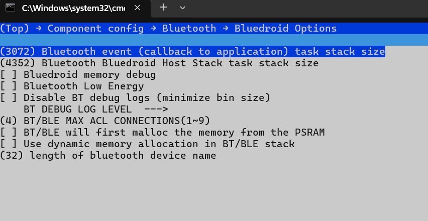

I found the solution.
In this topic: viewtopic.php?f=14&t=2455 I missed setting for the BR/EDR only..
I changed it via this way:
Controller Options -> Bluetooth Controller Mode and change the option to BR/EDR Only.
But then it didn't work the first time.
What I've learned is to delete the whole project folder on my computer and compile again (then change the settings again via menuconfig.bat and recompile the whole thing, and this time it worked.
I must keep this in mind for the future.
