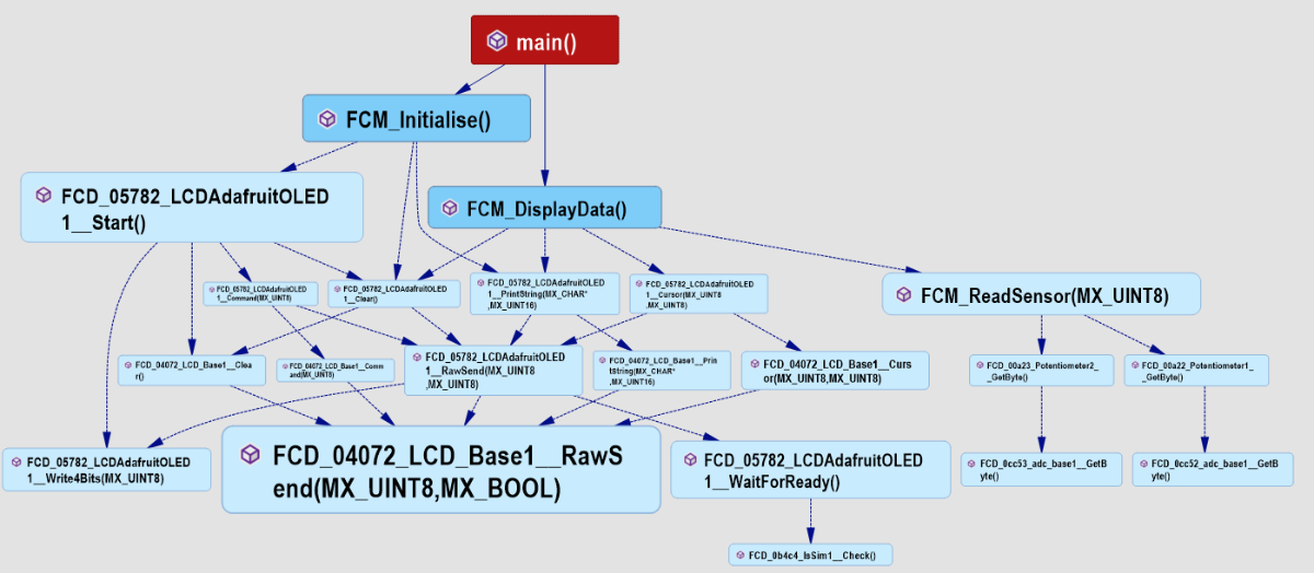

As an alternative, there may be some 3rd party tools that could help you now. For example, I've used a tool in the past called "Cpp Depends" which can generate graphical maps of macros/functions. Here's an example of it run on C code generated by a sample Flowcode project (also attached). The project is very simple - the "main" and 3 "FCM_" are the user macros - but the analysis can be complex as it shows all the component macros too. The map for a bigger project will be a lot more complex than this!
Flowcode C code Analysis.png (173.91 KiB) Viewed 12428 times
There are other tools that can do a similar thing.
