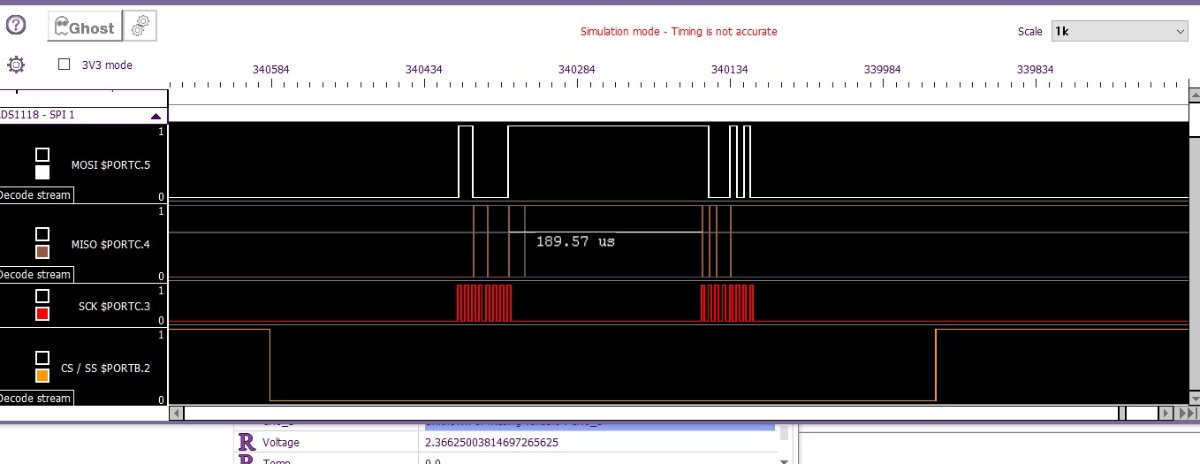

Hi Team.
I do not know if this is already in V9 that I just do not know it however you guys spoiled us so much with V9 that the wish list just do not have an end at the moment.(I know I can see the TX RX in console)
If we would/could have the SPI/I2C traces decoder in the scope/data recorder when Running Scada simulation that would be brilliant then we do not need a logic analyser or -and scope with our testing ONLY Flowcode what a beauty.
If the decoder would come as component like debug I will be the first one to buy it imagine all test tool in FC :D :D
The traces are beautiful but to decode it all the time is tedious and difficult then I rather connect my cheap Chinese LA which is also not prefect by it nature :D
We are allowed to dream :D :D right ?

Hi Peter,
On the left where it says Decode Stream, if you click this button does it do what you require?

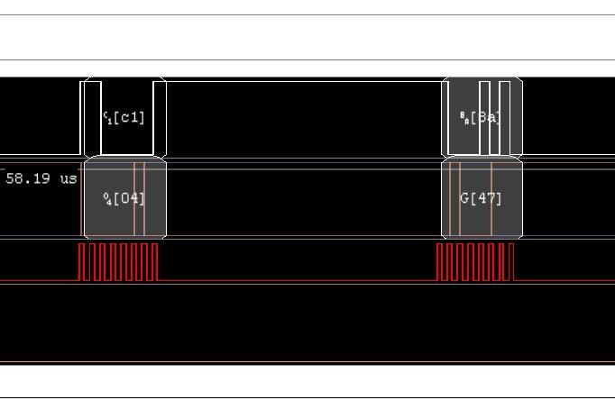

Hi Ben ,
Yes it does exactly what I want ,so many things I miss ,Sorry for asking this however I learned again something very powerful and helpful,
I can now pack the Chinese LA in the box and only work with FC :D :D :D
It seems it give the ASCII and HEX value in the decoder right!
