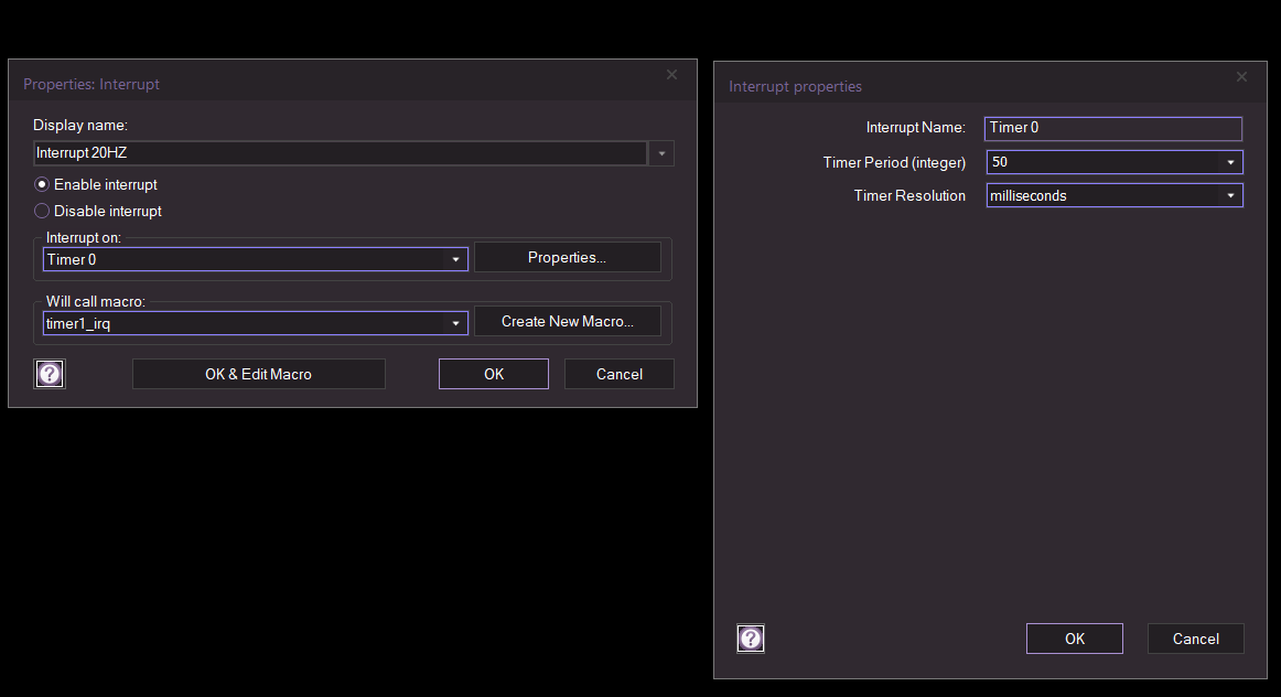

On ESP32 Wroom I have a problem with the Interrupt
I can set the interrupt to 20hz and it works very well. I can test this with the osciloscope and it works perfectly.
Only sometimes after a restart it happens that it is too fast and instead of 20Hz it has 25Hz or 50 Hz.
If I repeat the command 3 times it works much better.
The interrupt always works between 20Hz and 50Hz and only get faster, but not slower
Is there a possibility of reading a register or variable where I can test how the interrupt is set?
the interrupt is more stable if I do the command several times:
ESP32 Interrupt test if correct

Re: ESP32 Interrupt test if correct
The interrupt works well and is easy to set.
It also works when I use 80Mhz or 200Mhz as ESP32 clock speed. I don't have to change the code.
When I use the interrupt for the first time it is perfect!
Only when i want to stop the interrupt it does not stop and then the second time i set it it, is already wrong and from the third time it is even worse but then it stays this bad.it triggers too many interrupts, so that makes my interrupt too fast

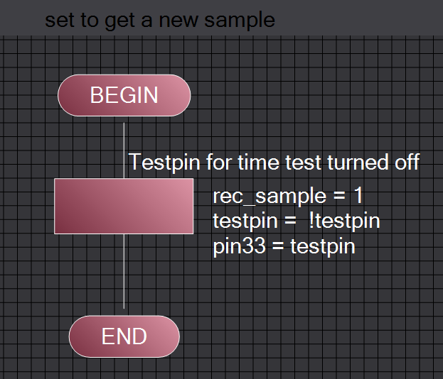

My test macro set on a pin33 for the osciloscope :

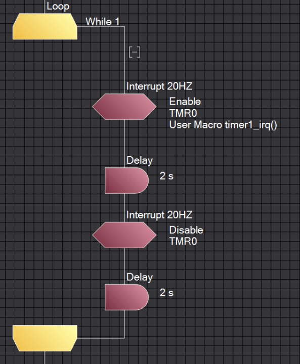

My testloop: All the printscreen:

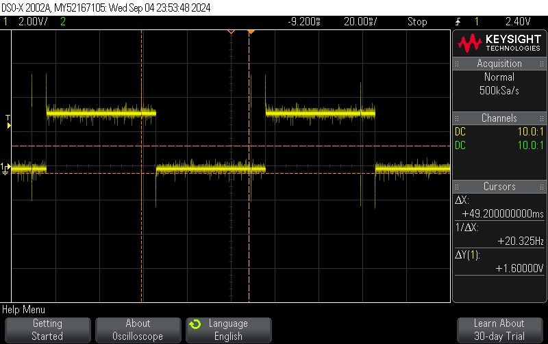

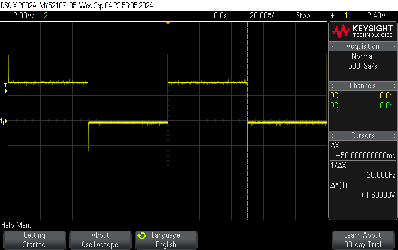

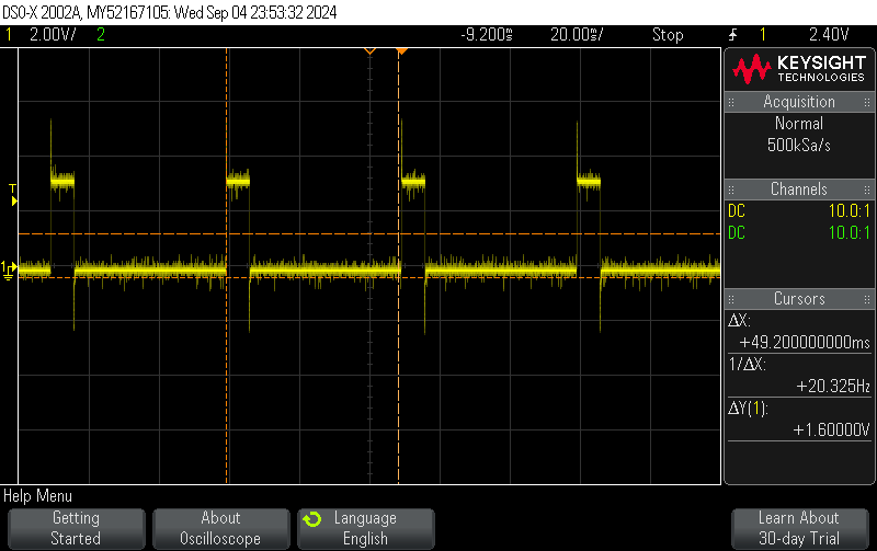

nice signal for the first 2 Seconds
Perfect! after 2 second
should be switched off. But is not Then later it's stable wrong:

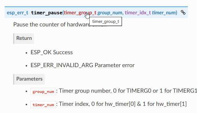

Could you try using timer_pause()
See https://docs.espressif.com/projects/esp ... tart%28%29.
Hi Martin
I will test this soon. I found the fitting command and parameter.
timer_pause(timer_group_tgroup_num, timer_idx_ttimer_num)
How exactly are these parameters to be used?
just like this?
timer_pause(timer_group_t0,timer_idx_t0)
for Timer group number, 0
and Timer index, 0 for hw_timer[0]
just like this?
I thought of a simple way to do it... All Flowcode too
So here - a simple example that toggles a pin every 50ms for 1s then pauses for 1s .. and repeats.
timer_pause seems to be for the newer timer component

- Posts: 1214
- Has thanked: 224 times
- Been thanked: 240 times
Hi Martin
Yes, your suggestion works. As long as the interrupt is only enabled once.
The interrupt should never be stopped
or be restarted.
or be restarted.
