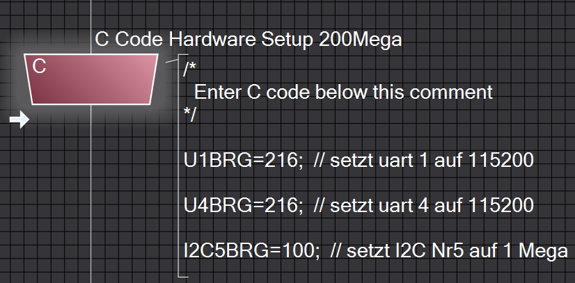

For my PIC32 I used C-code like this

Re: PIC, changing CAN bit speed Settings. BRP BRGCON1
Thanks Stefan,
I change the register values the same way. Using the C code.
