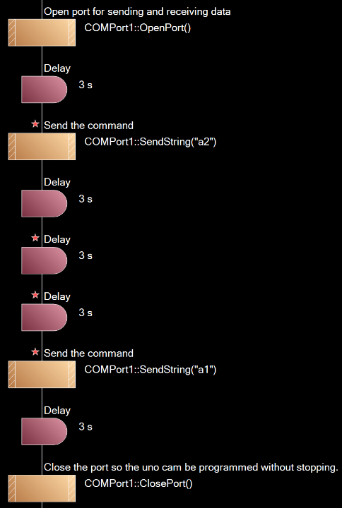

I changed the commands to my hardware, choosed to comport4
and pressed the button. my recorder started and stopped after 9sec.
So Your APP is working.

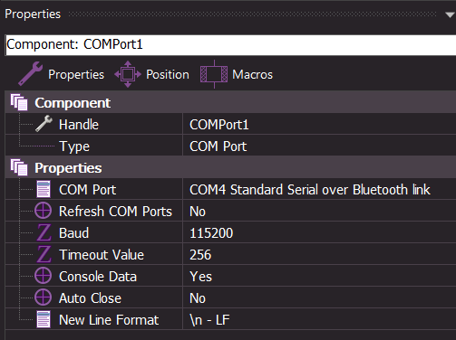

Maybe a config problem from the comport Nr ?

Posts: 2334
Has thanked: 647 times
Been thanked: 856 times
Re: A simple com sender
Flowcode doesn't create any kind of lock on VID/PID etc and should work with just about anything. I'm wondering if 3s is enough for the BT pairing to be established reliably. Could you instead have a button to connect, then another button to do the data send and then a third button to disconnect. This way you can connect and then keep trying to send data and then disconnect once the process has been done.
Posts: 2061
Has thanked: 311 times
Been thanked: 479 times
A few other thoughts.
There are sometimes issues when a COM port greater than 9 is accessed. You should be able to change the COM port used by your device to a lower one to see if that fixes the issue.
And have you looked at the "Serial Comms Worked Example - PC Developer" on the App Developer sample projects page? This is a very basic example, but might be a good starting point for testing your hardware.
