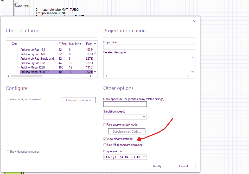

I need this to reload the program after making changes to the settings of the instrument I'm building, this practice is used by some manufacturers.
the first point you propose does not seem to be feasible because the reset pulse would be too small (also discouraged by atmel)
the second point where you call the call address 0 I will try it as soon as possible and it was also proposed on other forums as feasible and working
for the third point how should I do?
in the settings auto clear watchdog implies something?
thanks

Re: Tips for resetting the Arduino
I didn't try - but the pulse would stay high until the MCU resets?
The attached program demonstrates calling address 0... This works AOK.
WDT is used automatically - on PIC / esp32 etc but not so on AVR - again didn't test this.
