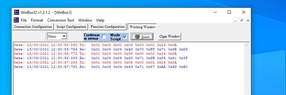

However i cannot see the Transmit LED flashing on my USB - RS485 Adaptor (shows as Com8 on my PC)
i have tested using winbus and i get a response from the meter.
Steve
Having some problems if someone could please advise,
When i run the the green arrow is flashing on the dashboard, the red arrow doesn't flash

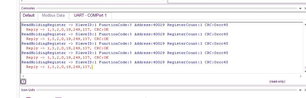

Re: App Developer - Modbus Master
hi Ben,
Is the slave replying ?, as the reply's in your you tube video's are blue with a green ok next to it.
Not getting much sense out of it at the moment
Steve
Steve
