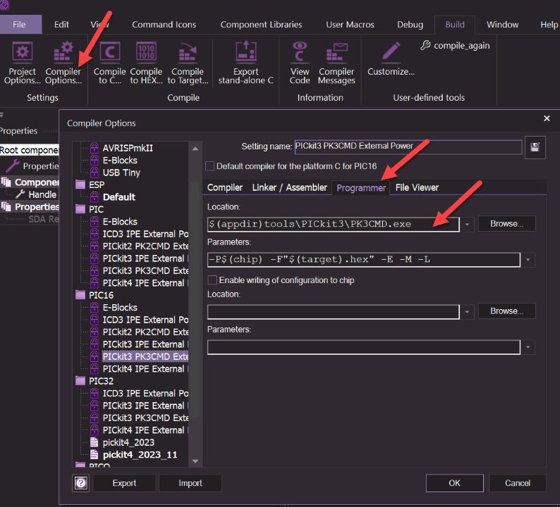

Re: My Pickit3 do not work
Hi Sergejs
You should also configure or select the PICkit3 in the programmer compiler option
- SNAG-0003.jpg (94.31 KiB) Viewed 4481 times
