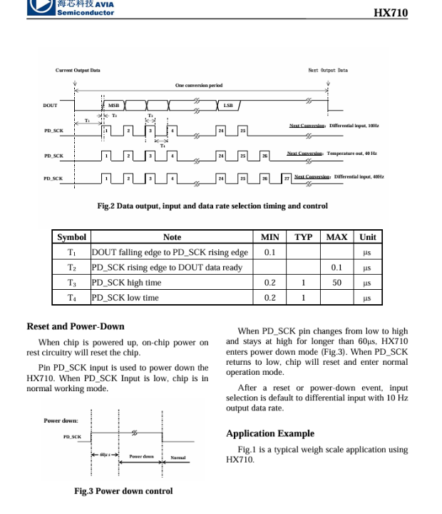

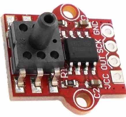

Is it possible to add an AIR PRESSURE SENSOR.
I have couple of things I would want to do with this type of sensor.
It uses a HX710B ADC to give an output, which I think is very similar to the HX711 used in weight sensors.
I also did a little experiment with the hx711 component. I get some result with it.
I think it would be very easy to modify the existing HX711 Load Cell to be an Air-Pressure sensor.
here's a link to the sensor.
https://www.homemade-circuits.com/hx710 ... o-connect/
Screenshot 2024-11-24 203556.png (143.1 KiB) Viewed 4889 times
Screenshot 2024-11-24 203622.png (117.93 KiB) Viewed 4889 times

Looks like a very nice little module.
