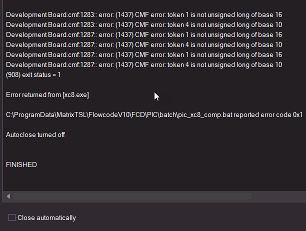

I am desperate to get a hex file out of the attached code but it is coming out with an error. Can someone please try to compile this to hex so I can narrow down the problem.
Many thanks
Pete

I also get an error with your program..

Looking at the CMF file - looks like an easy fix (or workaround) is to rename without a space in the name.

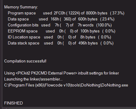

I saved it as db.fcfx and then it compiles AOK
Memory Summary:
Program space used 2FC0h ( 12224) of 8000h bytes ( 37.3%)
Data space used 169h ( 361) of 600h bytes ( 23.5%)
Configuration bits used 7h ( 7) of 7h words (100.0%)
EEPROM space used 0h ( 0) of 100h bytes ( 0.0%)
ID Location space used 0h ( 0) of 8h bytes ( 0.0%)
Data stack space used 0h ( 0) of 496h bytes ( 0.0%)

Thank you Martin yes that cured it for me didnt realise we could not have spaces

Yes, if I remove the space in the name it's compiling nice.

Flowcode itself should be ok without spaces, but some toolchains might have issues. Especially if 8.3 filename generation is turned off within Windows and an equivalent "8.3" filename is not available. I will look into this issue to see if there is anything else we can do to work around this.
We also see with some toolchains that the paths for included files can become very long and so keeping filenames short and installing toolchains close to the root folder of the drive help to avoid these issues.

I've looked further into this and not been able to resolve it. It seems to be an issue within the XC8 toolchain and so we can't fix it. I have found another post about this on our old forums from 2016, and so it's been encountered before:
https://www.flowcode.co.uk/mmforums/vie ... hp?t=17965
