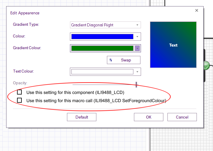

However, it would be really useful to set an appearance for a certain component or even a specific macro call right from the start.
For example, let's say I begin a project with a display, a PWM, and a LED array, and I place these on the 2D panel. I want to ensure that the macros for the display are visually distinct from the macros for the PWM and the LED array.
What I envision is the ability to assign an appearance at the very beginning of the project. Everything added to the project that relates to the display would then automatically inherit this appearance.
So, after adding the display, I would click on a macro call, edit its appearance, and check a box labeled something like "Use this appearance for this component." Even if I later add another component that interacts with the display, it would automatically inherit this specific appearance.
Something like this:
I understand that I can find a list of occurrences by clicking on a variable, a component macro, or even a specific macro call.
- appearance.png (53.02 KiB) Viewed 5404 times

Thanks for the further thoughts. I like the idea, but I'm worried about some of the details in implementation. For example, what happens when a call component macro icon is coloured for the LCD, but then changed to call a macro in another component. Should the colour automatically change? Keep the existing colour? There will be lots of odd details like this that could cause issues.
I will add it to our list though, and think about if there is a way to make work intuitively in all cases.
